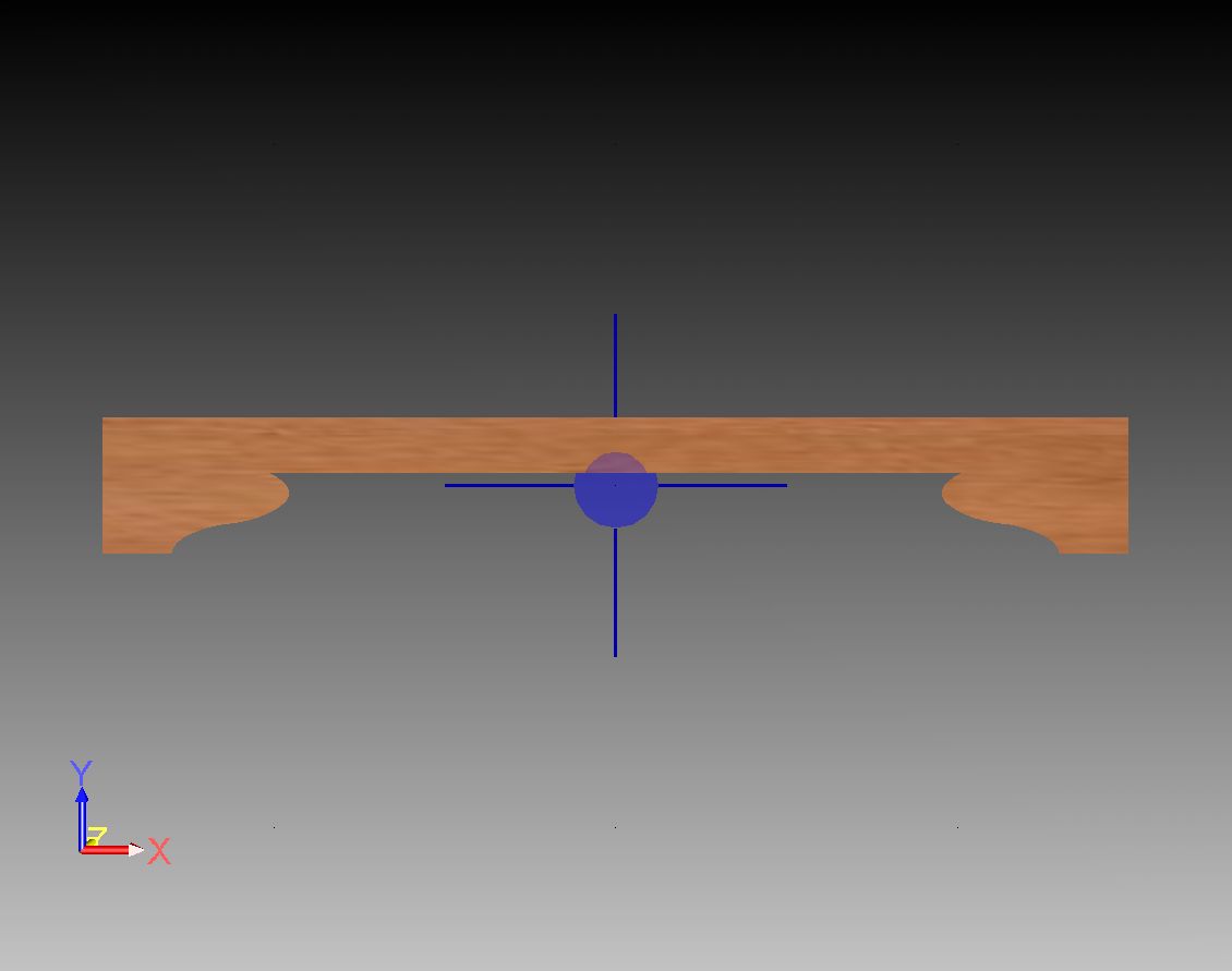

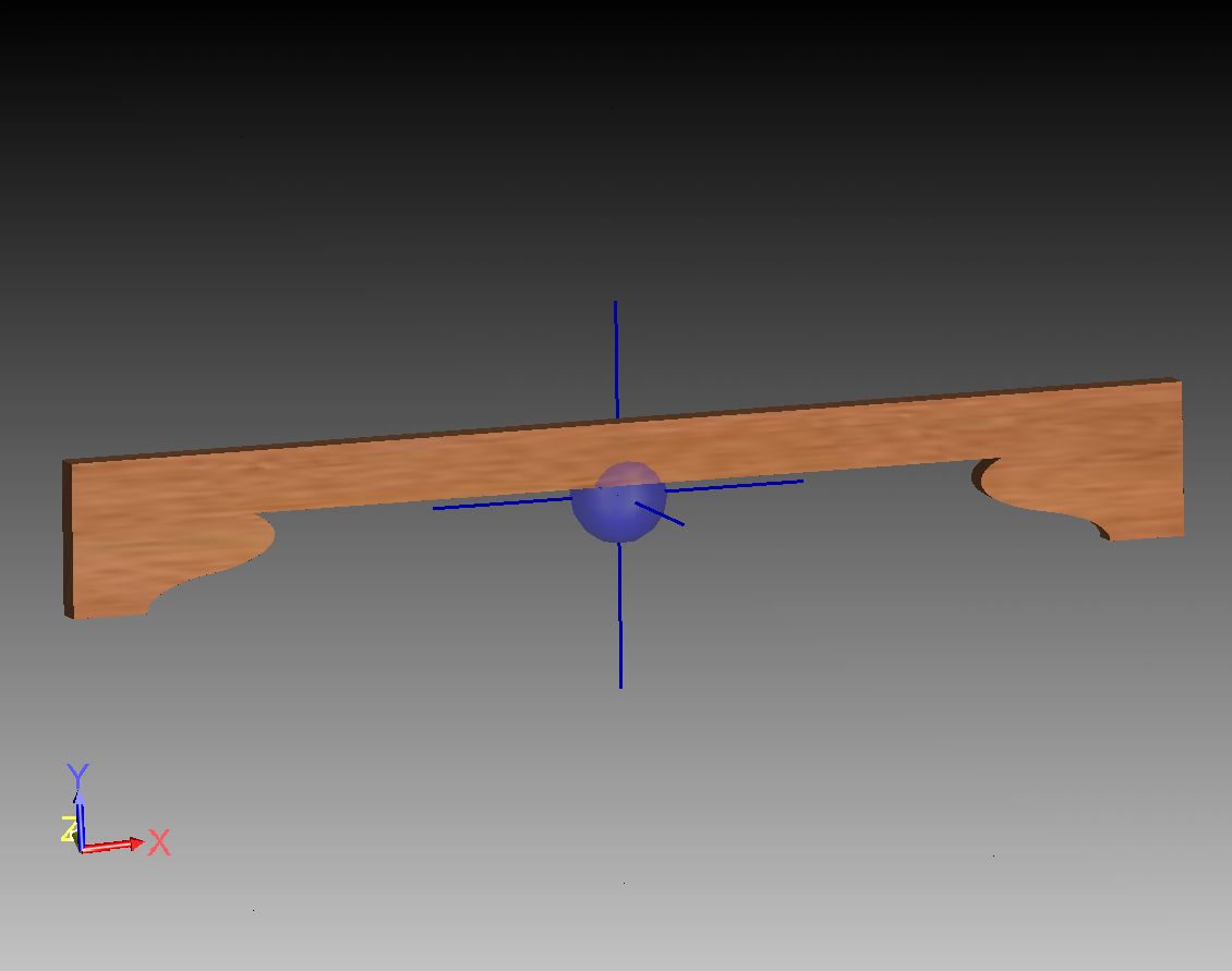

Hi everyone. I've had the e-cabinets program for a short while now and can do some basic stuff. I've modified the cabinets to fit my structure and have loaded them into the detail area and got a 3D picture with countertops and sinks and other stuff. I am now trying to make my standard decorative toekick and have be baffled. I've been trying to use the parts editor to remove sections of the toekick. I have been able to remove areas (like I did with the sink) but I cannot get the shape that I am looking for because I cannot use the spline function (doesn't seem to exist in the editor only the profile contour). Is there a way to import the shape I make in the profile contour into the parts editor or am I going about it the wrong way.
Welcome Leo, the area you want to remove needs to be completely connected as a closed entity, so make sure all your lines connect to each other.

Hey Leo,
You can create this using a dxf file. The dxf. file geometry must not be splines. Here I used an ellipse to creat this representation of what you want. I loaded the file in the part editor/contour.
-KB

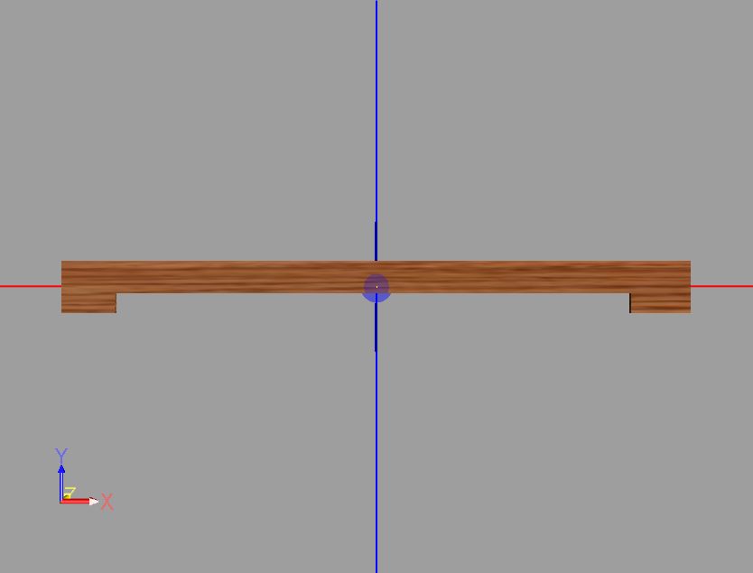

Leo,
I usually cut a couple of rectangles from the part, then use the fillet function.
Sean

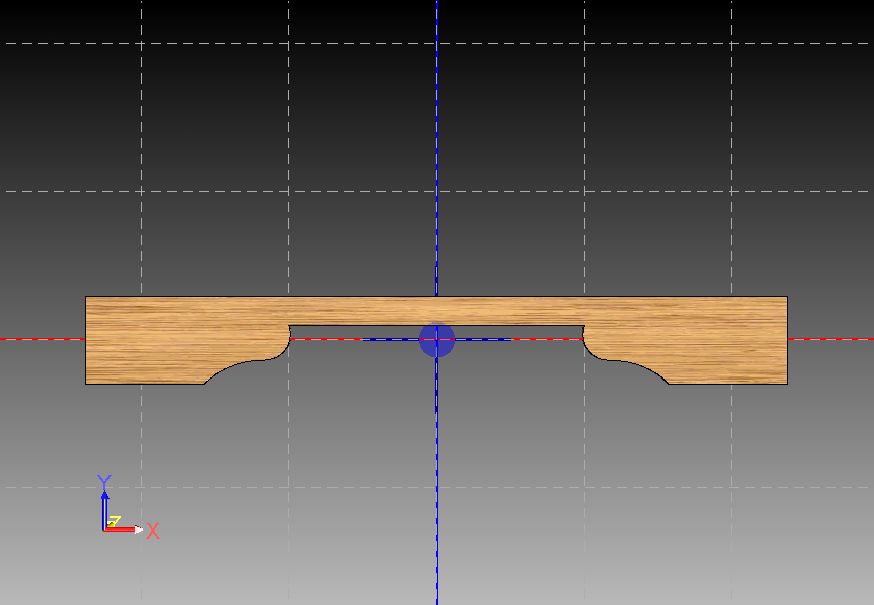

Hey Leo,
Here is the same result using eCabs only. You have to use several three point arcs but, you get the same results. I originally use used a .dxf file. I have used Autocad and other programs since I used to design industrial equip. and it was easier for me just to use a .dxf file. However, eCabs can achieve the same results as you can see. Just be patient with the software and you can do great things with it. Everyday I am amazed at what the software can do.
-KB

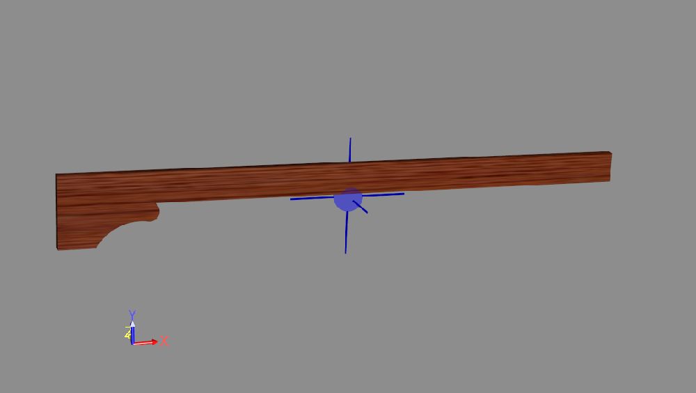

Well, it only took forever, but I did it within eCab. Used the parts editor using 3 point arcs, rectangles and fillets. The first one I did was upside down, why does it put horizontal parts in the vertical perspective. Oh well, it's done and figured out. Thanks for all the suggestions. I'll get this beat yet. Thanks again.
Leo

Nice looking cabinet Leo! And great job figuring it out with the Part Editor...

Hey Leo, looks like you got it. That looks great!
