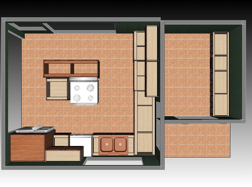

Actually there are work arounds to this problem . When I need to show more than one room I create a floor plan in wall editor. separating interior walls by an inch or so. Then change the direction of build to the walls as necessary.
This is one I did a fews yrs. ago when I 1st started using Ecabs.
Screen shot.jpg (104.91 KiB) Viewed 12386 times

David I have done the same also just opened the walls up like a peeled orange to show all of the cabinetry in a house at one time in one place and it all nests at the same time.
