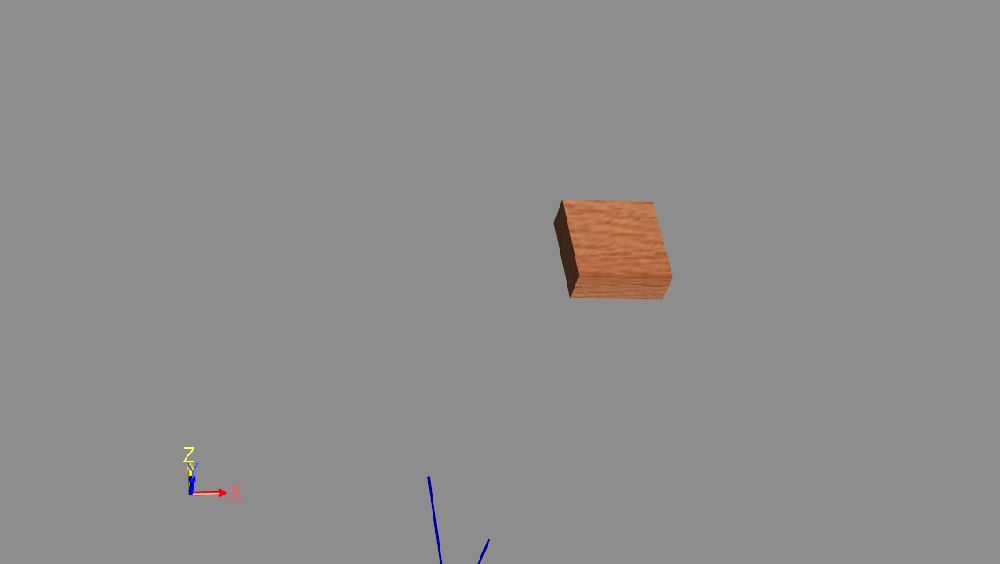

I have encountered 2 more problems in eCabs and was hoping someone has a solution or can put me straight. When I take cabinets to the Line Drawing editor and view them elevation, I can not see the internals, this even if I have hidden the doors. I need to go back to the cabinet editor and delete the doors, only then can I see what is in the cabinets. When I go into the counter top editor all the walls disappear making it impossible to draw tops. What gives?

Counter tops are created only from nodes on your cabinets so the wall don't really help. If you need to build a counter top over an open space or in corners I use a \"Marker\" to show where that corner etc. is. To create a marker take the Standard Base Frame less and make sure it is the height of your cabinets then delete everything but the top. Change the width and depth to 1\" or 2\" and you will have a little cabinet that you can place anywhere for the counter top editor to find and build a top to.
Hope this makes sense. It will show up on your cut list as a generic material and you can ignore it.
