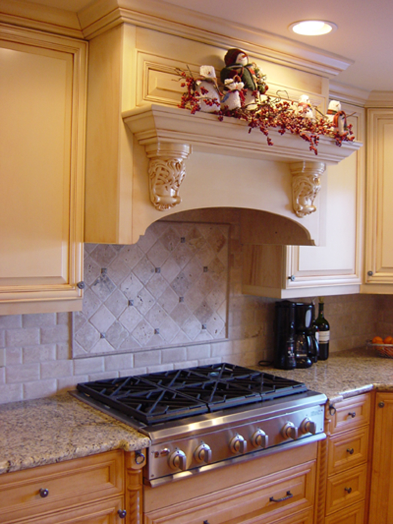

Post by DaleKern »
Tim,
The last one I did was 22\" deep, 42\" wide and was 26\" above the cooktop. Code requires 24\" in my area (check local codes as Dan suggests). The hood box measured 30\" tall, and the hood liner and blower (Dacor IVS1) was recessed about 4\" up into the hood box.
The most important is the proportions based on the width of the hood (the wider the better; Mike's design allows the most flexability) and placement of the doors, if any. I blew it on this hood - the doors are placed too low for my liking but the customer preferred it this way (and she pays the bills...). Hope this helps!
Dale
