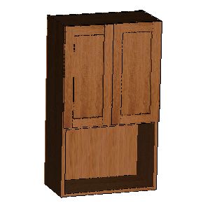

I hope someone can steer me in the right direction on how to add diagonal strips to the lower part (open) of this cabinet to create a wine rack. I have been trying for a couple of hours now and can't seem to find how. TIA.

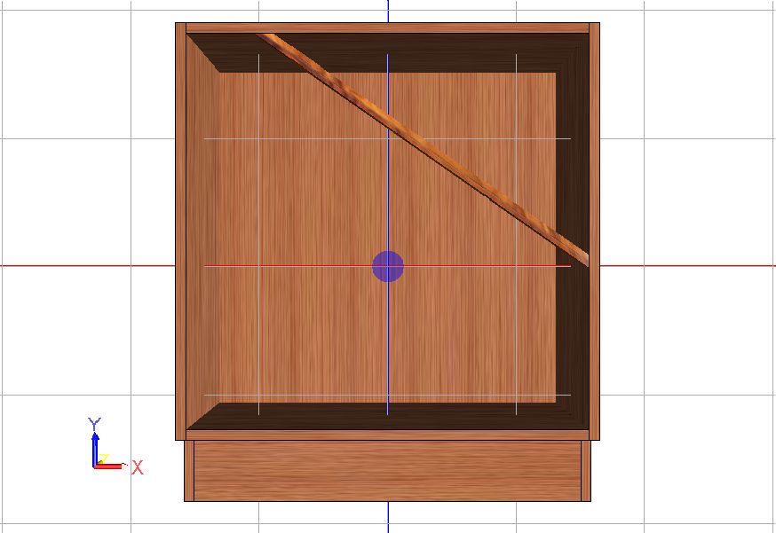

I was playing today I think this is the inside of your cab.
Here is one that I would do it.

Thanks all for your responses. Mike thanks, but George you hit the nail on the head, this is exactly what I want. I tried using display cubes to do it but couldn't place and trim them. How would you do what you showed.

Thanks Mike - That's not quite it but how did you put the shelves in the cab and rotate them?

Acutally it's a display cube sized to the inside dimension of that cabinet, then taken into Part Editor. Once in Contour Mode I figured out the geometry, made an outline of what you see, then back into Part Editor and used the Create Part Using Closed Contour option.

Make a display cube then put it into the parts editor. Then cut your squares into and cut them through. Go into the contour editor and make triangles on the corners of your cube to make it into a square (or rectangle) and go back into the parts editor. Right click the mouse and choose 'cut pocket using closed contour' then choose your contour, do this for the four corners and bring it back into the main editor. Make a copy of it using CTRL C & V. Place them into your cabinet and associate the grid with your cabinets and save.

Okay Leo -- If I understand you right ... you are starting with an over sized rectangle and cutting square holes in it .. then cutting off the corners and rotating the piece when you insert it to the cabinet? Thanks for taking the time to do this. I have been trying for the last 2 days.

Post by Leo Graywacz »
