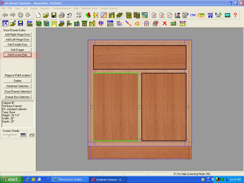

After you have selected a default pull, you must open your cabinet in the cabinet editor, go to the Door/Drawer Editor, Select a door or drawer front then Click on the Add/Locate Pulls button and tell the software where to locate the pull. Repeat for every door and drawer front, save the cabinet and your pulls will show.
