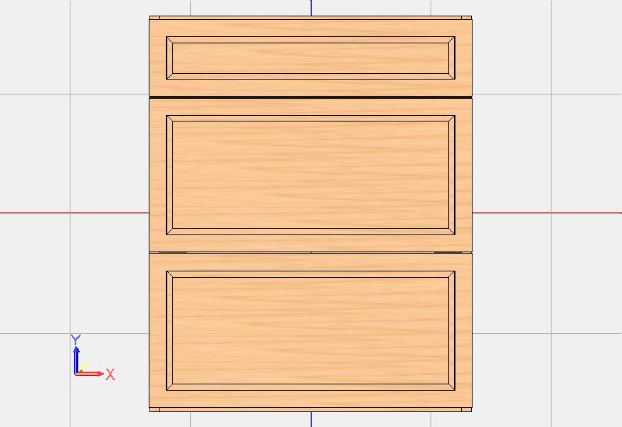

Roger Erismann
Posts: 169
Joined: Sun, Dec 04 2005, 11:42PM
Location: Sacramento, CA and Rolla, Mo
Post by Roger Erismann »
Joe...
Here is a picture of what I am talking about...I get the issue with the edge profile on the drawers but the inner profile, groove or bead or whatever we call it... is not nesting or showing up on the G-code after the TWD file is run...
I will hopefullyt be doing MDF doors here shortly..this is the first step in figuring it out...
Thanks again

Post by Joe Soto »
Roger, What tol. are you using? It looks like you only have the panel and no bead. Try one of the asymmetrical tools in the door designer. # 3 or 4 might be what what you are looking for. If this isn't the problem post the twd. and I will give it a shot.

Post by Joe Soto »
Roger, I get the tool is not valid in the door/drawer designer for the interior tool on the drawer front called dadoe.tol so that may be the problem but if I select the default door it shows the mitre.tol that looks like the pic you posted should they be the same? . Are you trying to do a 1 pass front or model it out usin the profile modeler? Give this a look.
