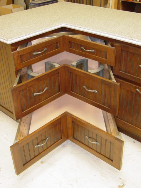

I brought this up before,but cab anyone help me with this, I started using a thermwood equipped shop to machine my parts for me and for my next job I have a corner drawer cabinet that I need to incorporate into the kitchen. This is going to be a Cherry beaded inset face frame job and I need to be able to do the corner cabinet with drawer openings like this

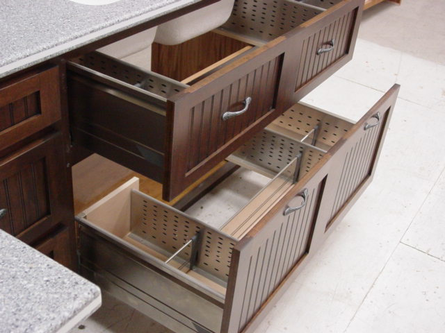

I also would like to know if it is possible to insert a drawer into a sink base cabinet like this and whether the part editor can do the notching for the drawer around the sink

I understand how to put the mid rails in the corner unit but I also need a partition on the left and right sides to be able to attach the slides to and they are flush with the face frame openings but run at a 45 degree angle to the face frame. Is there any way to accomplish that?

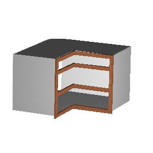

This is the corner cabinet without the partitions if it works

Corner drawers.hsf
(396.35 KiB) Downloaded 840 times

Denny Jahnz wrote:I understand how to put the mid rails in the corner unit but I also need a partition on the left and right sides to be able to attach the slides to and they are flush with the face frame openings but run at a 45 degree angle to the face frame. Is there any way to accomplish that?
I believe the only way you can do that is with a display panel manually placed and rotated to the correct location.

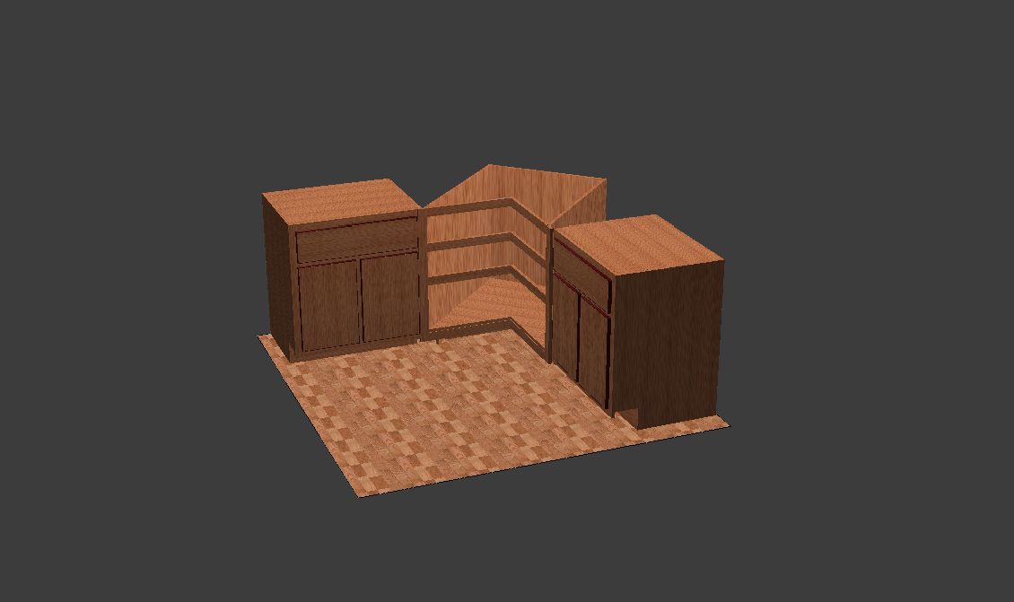

Denny, Just an idea, but if there are cabinets on either side why not use a regular drawer base with the corner face frame and the deck notched to matched. I threw together a .jpg to show what I mean, its not correct but you get the idea. As far as notched drawers not yet, but you could use 3 drawers with one turned sideways.

I have done these before..cutting a normal corner cab and then shop fabricating the partitions for the drawers is probably your best bet...
The alignment of the drawer slides and the drawer faces will be a challenge..
The partitions are easy to machine(mitres on opposite ends) and you can pocket screw them into the base...
Your top shoould be stretcher top and count on a couple of cleats to suck that partition into the cabside...
a good thing to get machined ahead of time is the drawer bottoms(if you are using tandembox) the odd shape and required precision really make this a time consuming endeavour...

For the sink base it can be done ahead of time but your measurements need to be dead on...
What we did was install the sink cab and sink then fabed our drawers from there....it was very quick..
