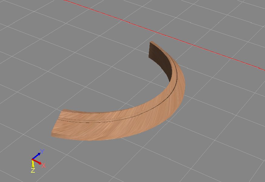

Are aggregate tools competible with Profile Modeler?
Roger and i are trying to run radius molding thats 3-4 inches thick and the profile is on inside.
Can this be done???

By design, horizontal tooling is not supported by Control Nesting. Horizontal tooling typically would not have enough clearance between parts to access side cuts. Also, typically parts using horizontal tooling require some sort of fixturing that raises part off of table to allow tool to reach for cutting.

Ryan...someone from thermwood is coming ourway this week...if it's you please come by the shop floor and say hi to Nano and Roger..anyways here is what we want(well we want radius crown but his is the start)
Wood Butcher/Case Maker

The pict. you've attached should be able to be done using Profile Modeler. The groove around ring would probably look nice with a regular endmill taking a single centerline type tool path.
