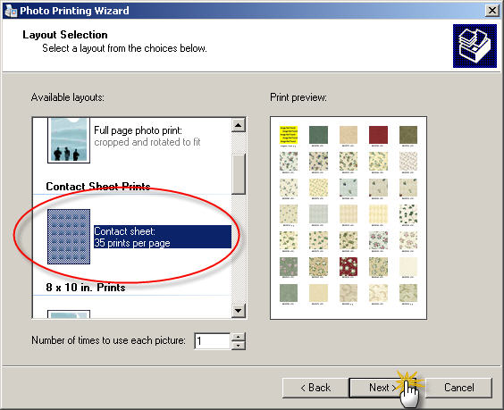

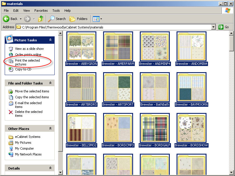

You can print a contact sheet from Windows Explorer. Just select the folder(s) you want to print, click the \"Print the selected pictures\" link on the left and follow the Photo Printing Wizard instructions.
Be sure you select \"Contact Sheet\" or you will get a page for each image (over 7500 if you select all materials folders).
You might want to print a single folder at a time since the file names do not have the full path.
Something else you might want to do is use something like PrimoPDF and print the contact sheets to a PDF file (saves a lot of paper and ink).
Print Wiz 2.jpg (53.04 KiB) Viewed 3166 times
Print Wiz 1.jpg (131.24 KiB) Viewed 3166 times
