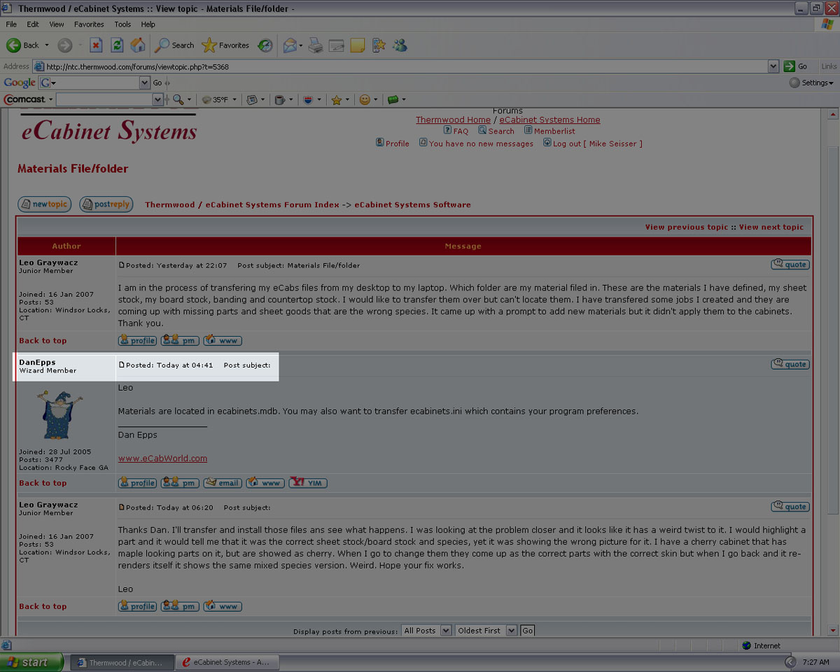

I am in the process of transfering my eCabs files from my desktop to my laptop. Which folder are my material filed in. These are the materials I have defined, my sheet stock, my board stock, banding and countertop stock. I would like to transfer them over but can't locate them. I have transfered some jobs I created and they are coming up with missing parts and sheet goods that are the wrong species. It came up with a prompt to add new materials but it didn't apply them to the cabinets. Thank you.
Leo
Materials are located in ecabinets.mdb. You may also want to transfer ecabinets.ini which contains your program preferences.

Thanks Dan. I'll transfer and install those files ans see what happens. I was looking at the problem closer and it looks like it has a weird twist to it. I would highlight a part and it would tell me that it was the correct sheet stock/board stock and species, yet it was showing the wrong picture for it. I have a cherry cabinet that has maple looking parts on it, but are showed as cherry. When I go to change them they come up as the correct parts with the correct skin but when I go back and it re-renders itself it shows the same mixed species version. Weird. Hope your fix works.
