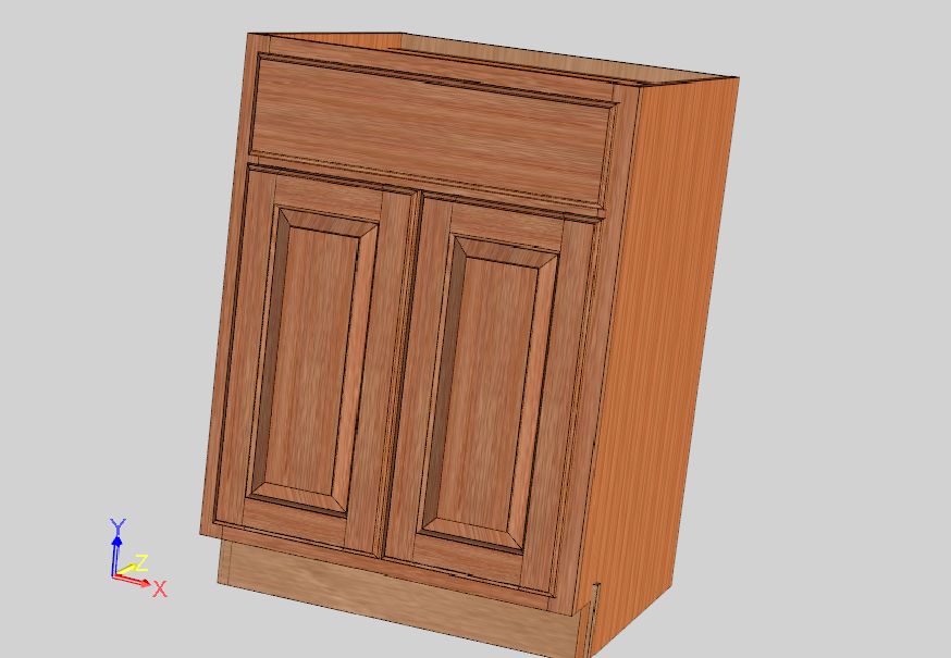

Here's an example of the problem.
Tim
B2434.5BD.hsf
(283.55 KiB) Downloaded 816 times

Tim,
I deleted the doors, drawer and shelf then turned off face frames.
I then turned face frames back on added the mid rail, shelf and doors and drawer back. It seems to be working fine.
That doesn't help with what caused your problem though.

Tim
Did you make this cabinet from a v5 standard cabinet or is this cabinet from an older build?

Post by Tim Kulin »
The cab was originally built from version 4. It's part of a large standard library I use.

Tim,
In v5 we made a lot of changes for the doors and drawers. These changes where made to help the placement of the drawer boxes. So if the doors and or drawers that are on your cabinets are from v4 then that is the problem. You will need to delete them and re add them to avoided further incorrect placement.
