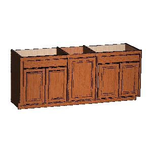

I am creating an assembly with 3 base cabinets. On the outside 2 cabinets I am deleting the left side and style on the right cabinet and the right side and style on the right cabinet.
When I take the cabinets in to the door editor to add doors, the left cabinet works fine. The right cabinet adds the doors with the left door inset 1/2\", and the doors are 1/2\" undersize. The drawer front did this also, but I put a neg. inset on the left side to fix this. I just can't come up with a fix for the doors.
Is this a bug or am I doing something wrong? I've made lots of assemblies before and haven't had this problem. Seems like I ran into this after the new build. Thanks.

Gene Kimmi,
Do you have the proper insets for the said cabinets. And the only other thought would be you may have a scribe set on this cab.
Can you zip the assembly and post it please?

Here is the assembly zipped. I have put together several more today that I am having the same problem with.

I'll give this one some more time later today. It appears to me a few things may be adding to this.
One observation is that different settings for the left and right cabinets. Also, I anticipate the actual problem is with the cabinet on the left, not the one on the right. I say that because the right cabinet is producing the expected results for the settings.
I played with it for a while and saw the same results on a std cabinet on the same sides. Like I said I think the left not the right is the problem.
