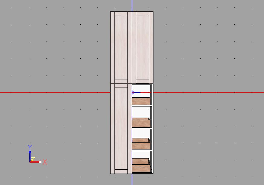

Hey Marvin, this is the way I do mine. I use fixed shelves with back inset (rail) that way I can adjust my openings easily. You can make the rails 1/8 wide by adjusting your back inset that way they won't interfere greatly with your nesting diagrams.
TB24 4V.jpg (28.42 KiB) Viewed 4707 times
