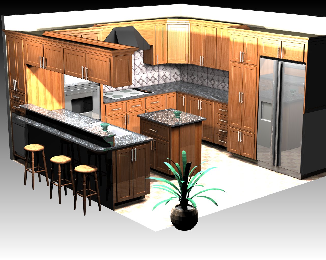

This is an nice kitchen that i did for a customer, all in Jatoba with plenty of features.

Francis Samson,
Beautiful job...
It appears that the ceiling is higher than the cabinets. How is that cabinetry above the penninsula susspended? Or is the ceiling height to the top of the cabinets?

Thank you Michael, to answer your question, yes it is suspended and the ceiling was 12' hight!!! :roll: I just attached the glass cabinet with a post from the ceiling and reinforced the cabinet with blind dado and a double top for the weight compensation and some idden toggle bolt inside the module to the ajustable post!
A bit more work but i'm sure that it won't fall!!!!

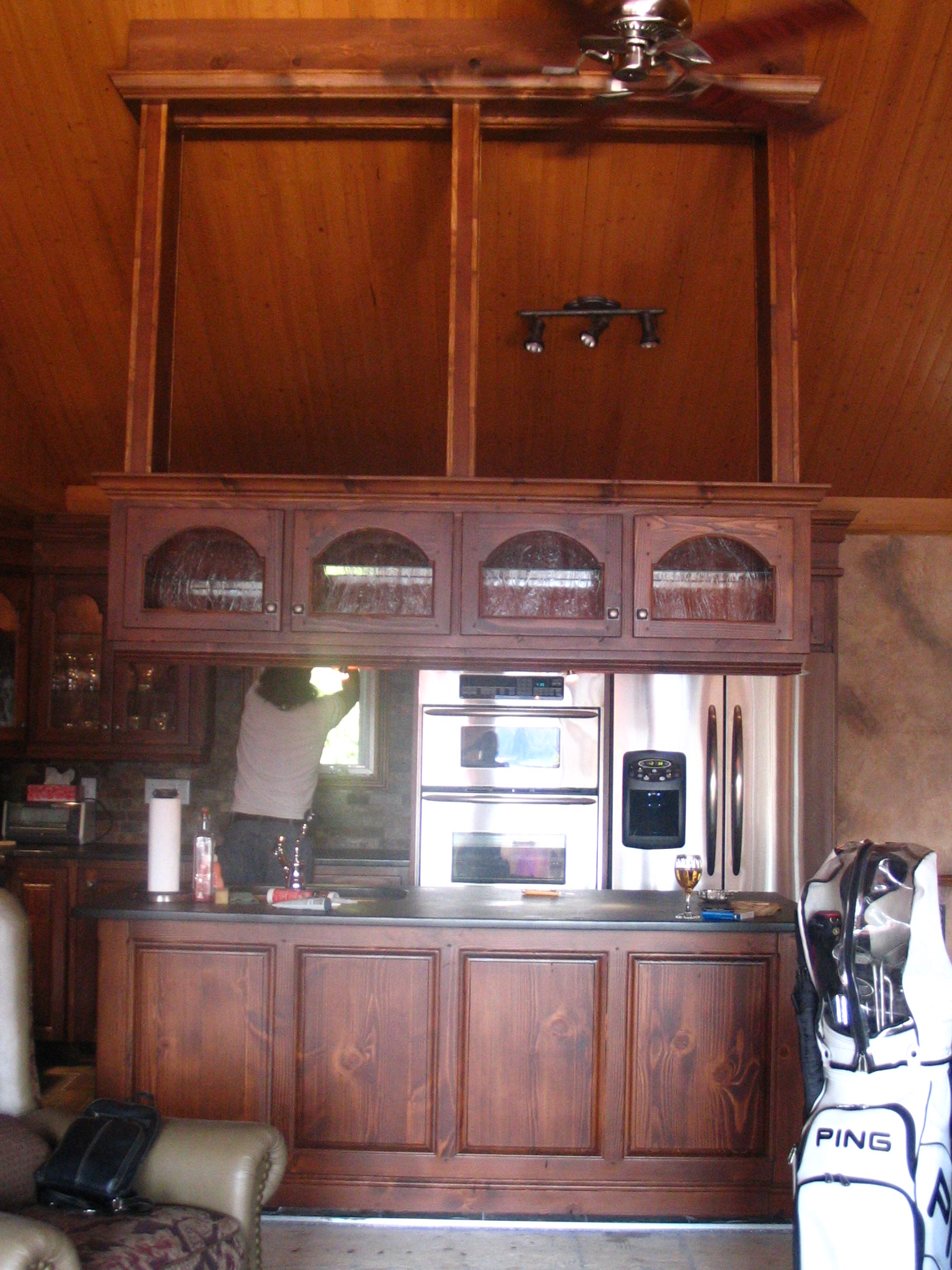

I'm posting another one like this but that was attach to a cathedral ceiling :twisted: ! This one was a major project, beleive me. I had a metal frame being made with all the angels and dim. that we coverded with the same finish wood (that was actually an old barn that i salvaged)!!! Got a lot of antique jobs like this over here and since the price of the wood is so crazy, every recycling works in these cases on antique finish!!
