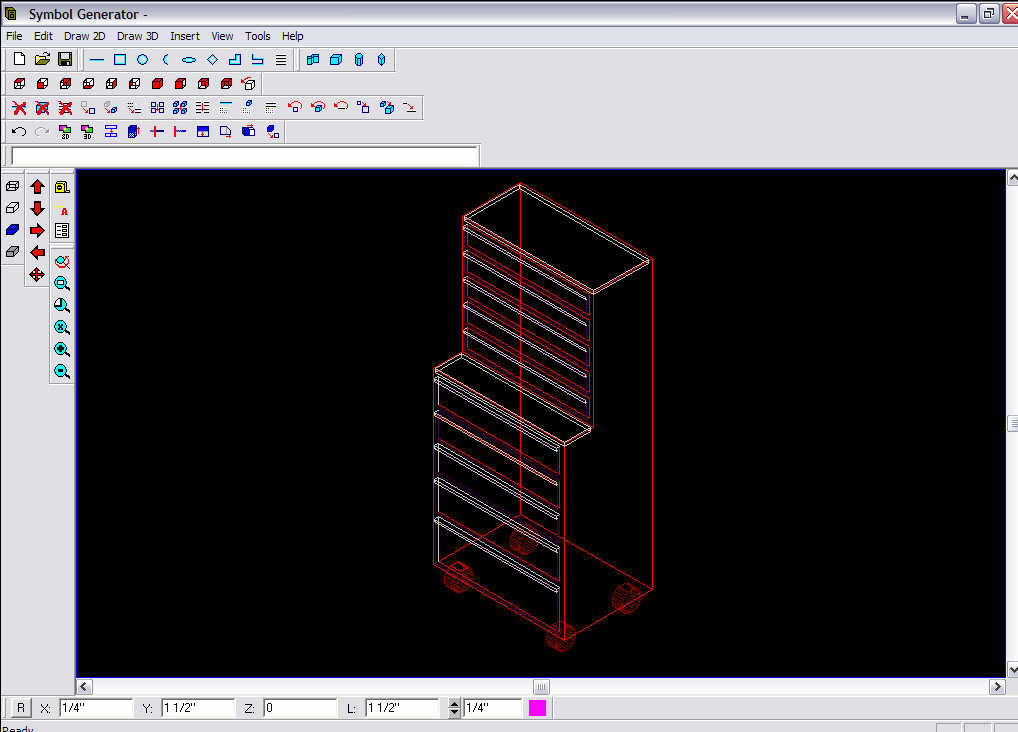

My up grade from SoildBuilders has a
Symbol Generator with it. The up grade was $600.00
I have had the up grade for about a year now I never used the
Symbol Generator. They are do for a upgrade this year it will run about #500.00. Back to the Symbol Generator I timed my self it took
18 min to make this tool box. Now how do I take it out of SioldBuilders and
put it in to e-Cabinets.I have to take it in to SoildBuilders I can turn it in to a Dxf file in SoildBuilders :?: I get lost then :wall:
Symbol Generator.jpg (82.7 KiB) Viewed 2563 times
George,
You will have to open the .dxf you saved in Accutrans 3D and use that to convert the different layers of the file to stereo-lithography .stl format. You can then open the .stl files in the display parts editor and texture them and save them as a display object.
If you are having trouble with Accutrans, email or PM me a phone number and a time and I will call and walk you through the procedure or upload the .dxf and I will be glad to convert it for you.
