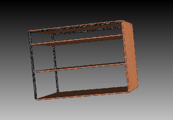

Instead of using stretchers horizontally, use fixed shelves with insets. Then you can use stretchers between them.

Hi Paul Will this help any I cut out the shelfs.
Here is a shelf bracket (You can resize it)
I have to go I am painting one of our apartments for May 1
I was letting the paint dry it will need a 2nd coat
Paul I hope this will help a little

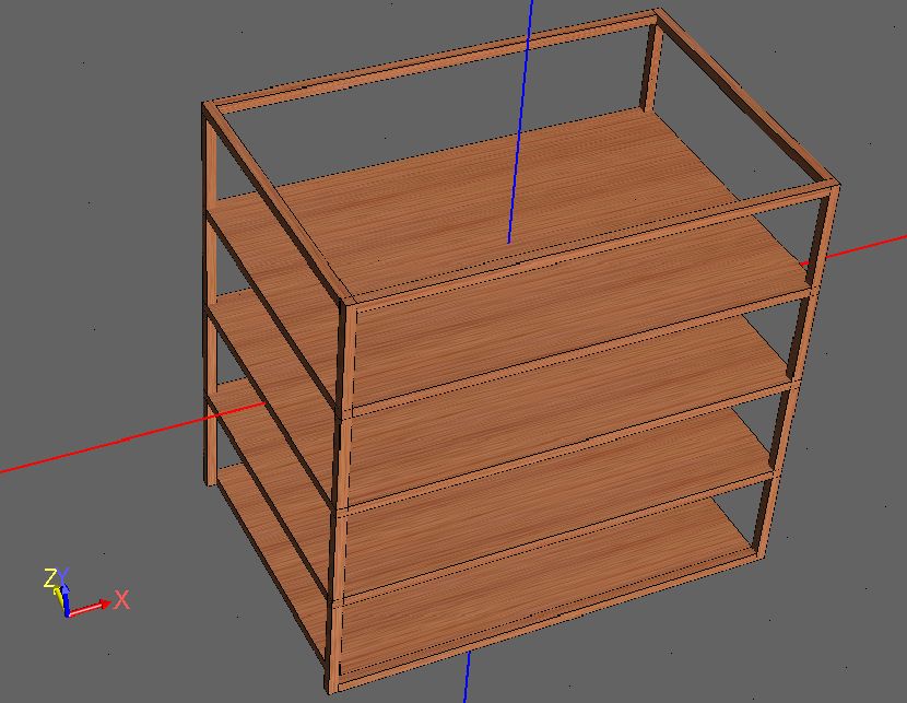

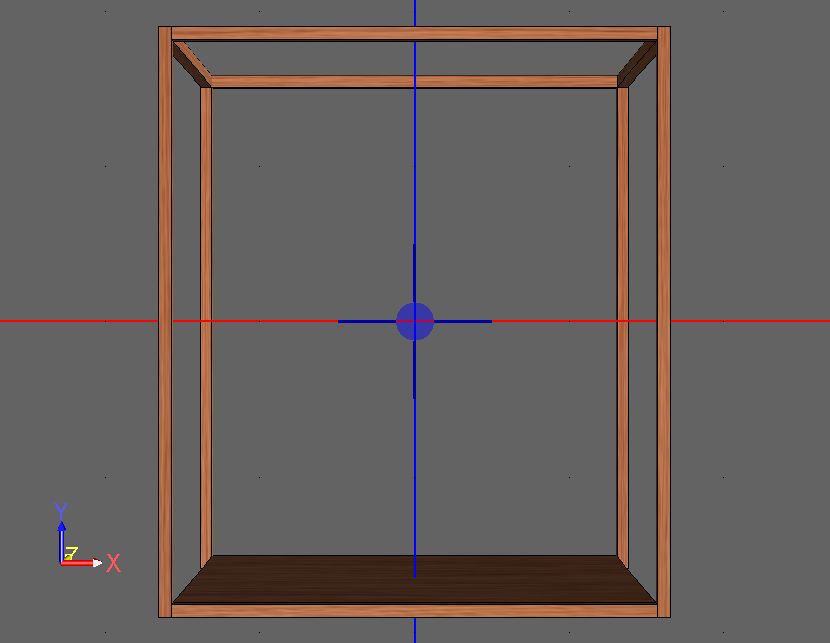

Sorry for taking so long to get back to you Paul. This is what I have come up with if it helps.
frame.hsf
(180.55 KiB) Downloaded 530 times

Rick and George,
Thank you both! Between you two you have practically built everything I was looking for!
Now just to build the whole thing
