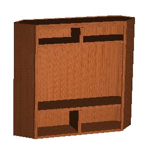

I am designing a large corner entertainment center. I need to add mid styles and partitions. The drop box in the ff editor doesn't have a mid style to add. Nor does the shelf and partition editor have partitions to add for a face frame angled corner cabinet. I guess I never noticed this before.
I'm guessing I will have to add display boards and panels to use for the mid styles and partitions then load the doors and drawers and associate them in the main editor rather than in the door and drawer editor.
Does this sound right or am I completely loosing it on this one? Here is the cabinet I am working with.

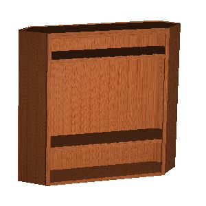

This is my wobbly start on this one. I used a display panel, 2\" wide and the same height as the cabinet. Then positioned it carefully to appear to be a part of a face frame. However, I was not able to change the texture.
I wanted to give this a shot, as I am learning a little bit at a time. I would be interested to learn if this would be acceptable. Is THIS waht you meant, Gene?

That's along the lines of what I'm trying to do. I need to have a center style in the top and bottom opening of the cabinet. I also need a partition behind each style. Then I will put glass doors on the top openings. On the bottom, I will put doors on one design and copy another design with 4 drawers on the bottom.
Here is the cabinet with the center styles the way I need them.

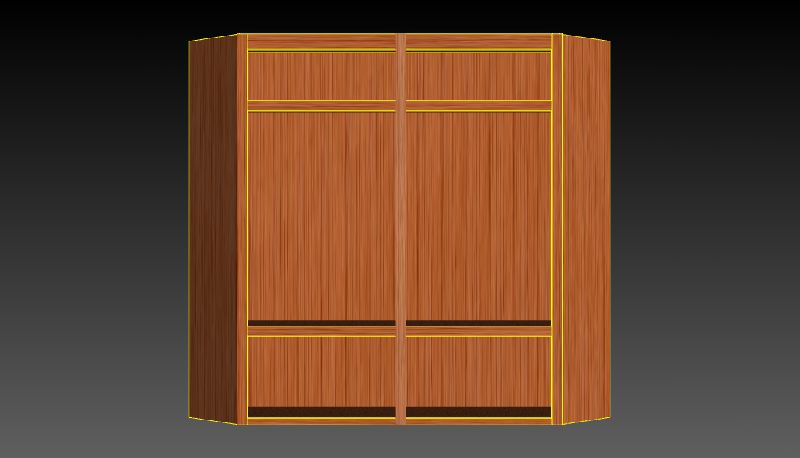

Here it is with doors. Sure is a lot slower adding parts one at a time. Also makes me think too much. :lol:

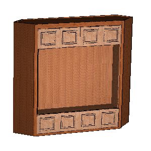

Gene, you could build a second cabinet to fit inside the angled cab. Just remove the top, bottom, sides and back. That should make your doors easy.

Rick Palechuk wrote:Gene, you could build a second cabinet to fit inside the angled cab. Just remove the top, bottom, sides and back. That should make your doors easy.
Sheer genius, Rick! Thanks for teaching me such a valuable lesson. I must archive this one somewhere special.

I'll second Al's comment. Below is the cabinet using your idea. Doing this I ran into the same problem I'm having with all my assemblies in which I delete sides off a cabinet. The doors will not place right on one side of the cabinet.
