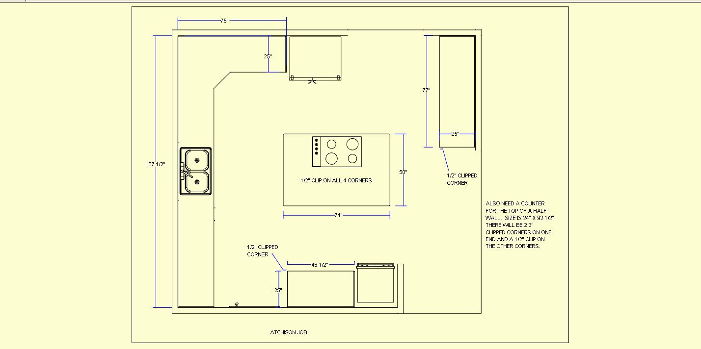

Is there any way to take a counter top from custom layout to LDE and show dimensions. I believe I have done this before but my pea brain can't figure it out tonight.

You can take the custom layout to the LDE then right click, and under select mode click cabinet. Then click on all the cabinets and click the hide buttom. This will hide all cabinets and make it easier to dimension the tops. Here is one I did today.
