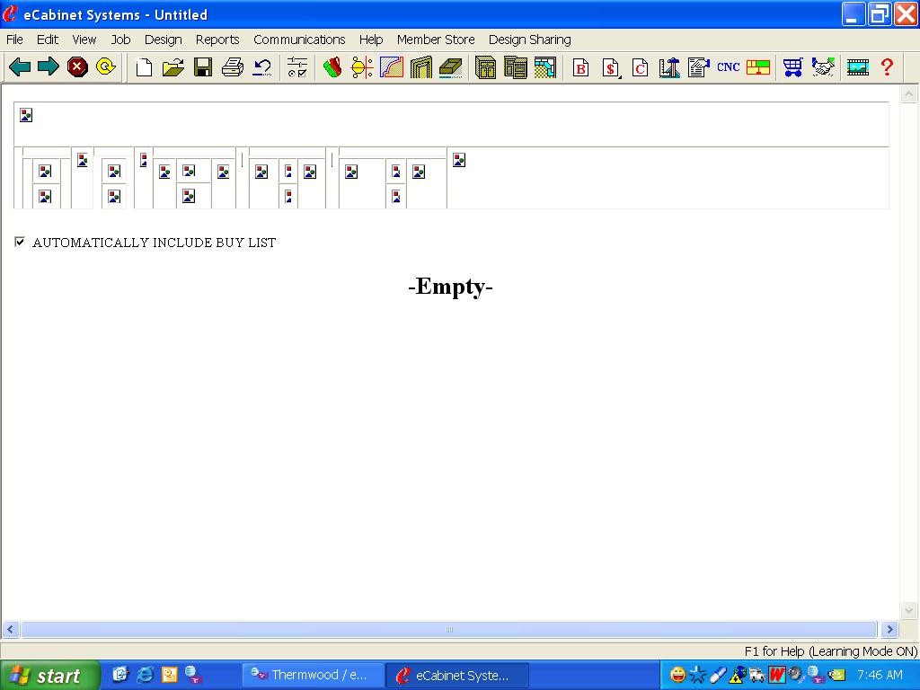

Any clue why there’s no text since down loading 5.1 3 see attachment.

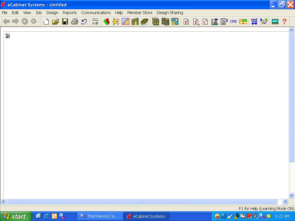

Hi Todd, Here are the screen shots as the program opens.

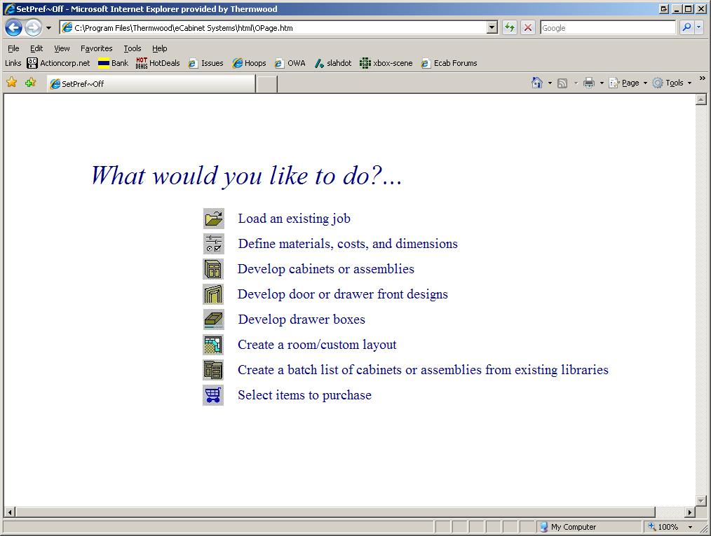

ok. First try this. go to you web browser and enter
\"C:\\Program Files\\Thermwood\\eCabinet Systems\\html\\animated_ecab_greeting.htm\" in the address bar. It should look like the jgp below. If it dont, you need to uninstall and reinstall the patch b3. This file is not in the orginial install. It was installed with the patch.

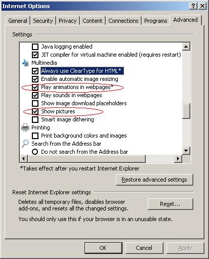

Ok. i looked a little more into it. If I delete my page, I get a error message when loading ecabinets. You do not. So, I checked my internet settings. After disabling a couple multimedia options, I was able to get the same results as you. So, could you please check you IE settings. Open IE, got to Tools->Options, click on advanced tab, scroll down to Multimedia. Play animations in webpages and Show Pictures should be checked.

Rick you’re a genius, thank you for help, it is very much appreciated. :D
