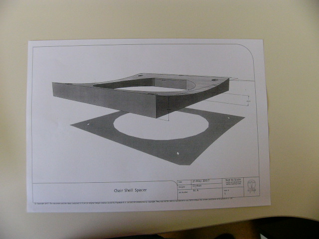

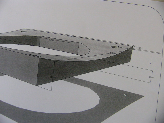

Its a panel thats 170mm square and 18mm thick. It has holes in it and thats not the problem. What i cant figure out is how to do the curve thats on the face. it goes down to 10mm in the middle of the board.
Can i run it with just the curve in it then nest the same size panel with the holes in it?

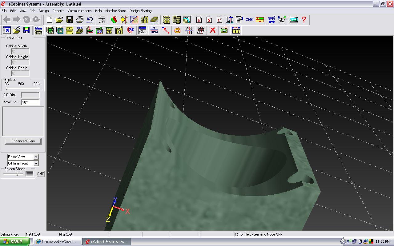

Thom, try this, create a tool with the radius of the face of the part, make the part, cut the holes then draw a line down the center top of the part to set the tool path, then select your new tool. I did a rough test and it works
Joe

Hey Joe
Man that looks wicked!!!! Thank u heaps ae! Just a few qu's. You made a tool to make that shape, Im going to be running them on the thermwood, just cos the tool was made to the shape do i need to have a tool that shape? Or can i do it with a bull nose cutter?
