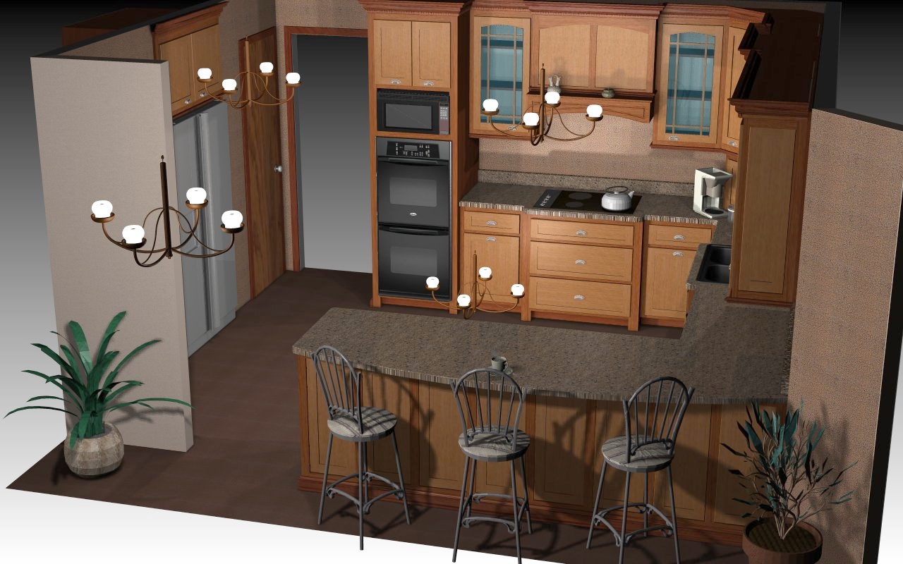

Here is my latest design drawing.
Slide Show
Looking good kid

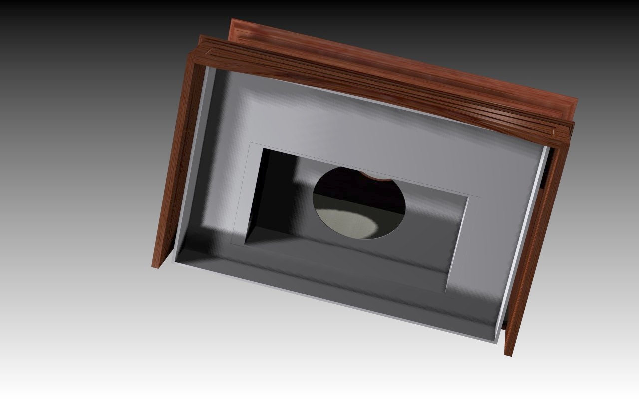

Did you make a hood liner in e-Cabinet or can you order a liner for that hood wih fan :?:
Kerry I think I am going to order some of the door (sure hooks)
for spraying doors.
Posts: 4763
George,
I draw the liners that I use in eCabinets so I can make sure they fit. This one has a Dacor Liner. By installing this I know that I need two 3/4 spacers on the sides to mount the liner in this hood. It also lets me know where to cut the hole in the top.

That's an excellent presentation Kerry ! I like the way you build your cabinets with the full length left and right stiles. I use that method also and I think it gives a nice finished look. Is that a garage door on the corner, or a pocket door ? Great work as always.

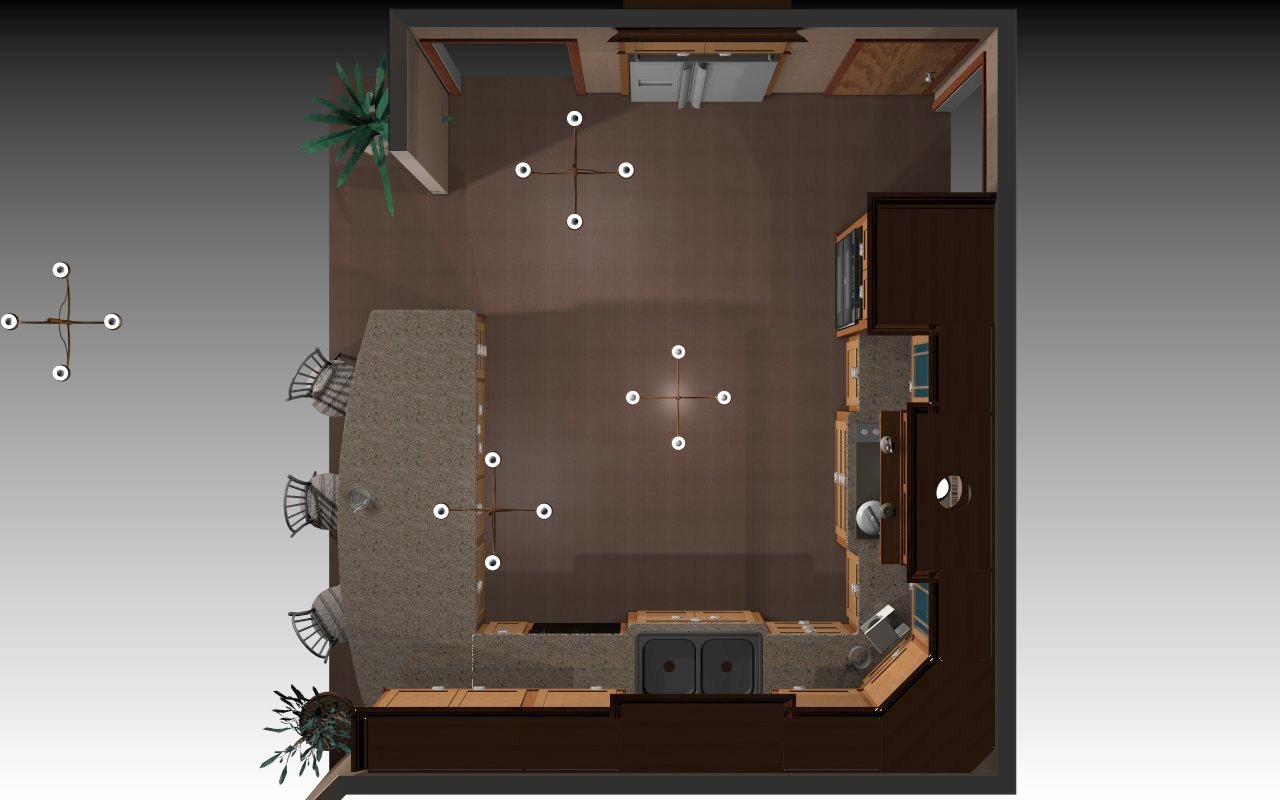

This is a great rendering. I would like to see where you positioned your lights to get the results you did.
John
Posts: 4763
John,
This is the most lights I have ever used to render a view but it worked for this room.
There are three chandeliers overhead and one at cabinet height. There are also cans in the hood and window valance with an intensity of 8.
The chandelier outside the room has an intensity of 40, the other two overhead have intensities of 10 and the one at cabinet height is 20. As you can see I used several different textures so that I can adjust the shine of different parts of the cabinets and objects to create a more realistic view. The lower light levels enrich the colors in the room. The biggest mistake I see members doing is too much light. Use as little light as you can and simply change positions of the lights to highlight cabinets. You may have to move the lights for every rendered view that you do.
After rendering my views and saving them as jpegs, I take them into Irfanview give them a gamma correction of +1.20 to 1.30 to brighten the views without washing out the colors. The slide show photos were all done this way. The photo above was also taken into PhotoShop where I added a slight Gaussian blur to create a little haze in the room.

:shock: MAN, I wanna be able to render like that when I grow up!
That is truly an excellent job, Kerry!
How long does it take to create something close to that, once you have build up your libraries/files?

Kerry Fullington wrote:...There are also cans in the hood and window valance with an intensity of 8.
The chandelier outside the room has an intensity of 40, the other two overhead have intensities of 10 and the one at cabinet height is 20...
Thanks, Kerry. Terrific rendering!!!
I don't understand HOW you are setting the intensity for each individual type of light. I am unable to locate a control that allows me to do that.
I wonder if you would mind sharing how you adjust each one? Thanks!
Al

Kyle,
I have around ten to twelve hours in this design. I have had as many as 40 hours in a design. It all depends on how the space works, how many changes have to be made and how much detail I want to provide such as do I show all of the moldings, do I profile both edges of the counter tops or just one? I can spend several hours adjusting lighting and textures and display objects. I wanted dishes in the glass cabinets but eCabinets locked down every time I tried to place them so I gave up.
Al,
Render your view then right click on the light fixture you want to change and choose adjust light intensity and set a value. If you want an intensity of less than ten, enter a value in the numerical entry box by the light intensity slider at the bottom of the render then right click on a light and choose Apply Dialogue Settings. Repeat for every light. Once you get all the intensities set you can exit and hide the lights and render the view without the fixtures showing.
Last edited by Kerry Fullington on Tue, May 29 2007, 7:47PM, edited 2 times in total.

Kerry Fullington wrote:...Al,
Render your view then right click on the light fixture you want to change and choose adjust light intensity and set a value. If you want an intensity of less than ten, enter a value in the numerical entry box by the light intensity slider at the bottom of the render then right click on a light and choose Apply Dialogue Settings. Repeat for every light. Once you get all the intensities set you can exit and hide the lights and render the view without the fixtures showing...
I had no idea that you were able to do the light adjustment in the rendered image. I will try it, Kerry. Thanks!
