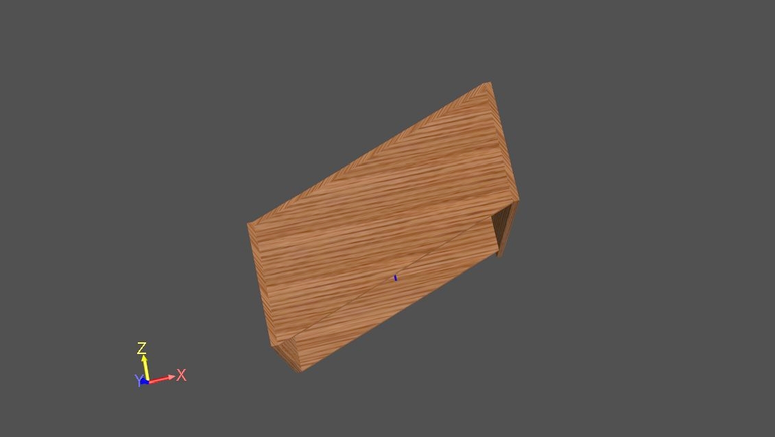

KyleHepp,
Is this anything like you need?

Kyle,
I have been with this program for a few years now and am no stranger to the corner cabinets. Maybe I don't understand your need. If you like you can PM me with a # and I'll be glad call you to help you through this.
I have cable ISP so my computer is on the internet all the time, unless it's asleep. Many of us respond to the messages because we get instant messages sent to our email box and we are notified the moment it arrives.
Short of a remote desktop connection, the phone is the next best thing. Like I said, PM me and I'll be glad to help you if I can...
Here's another angle cabinet too
