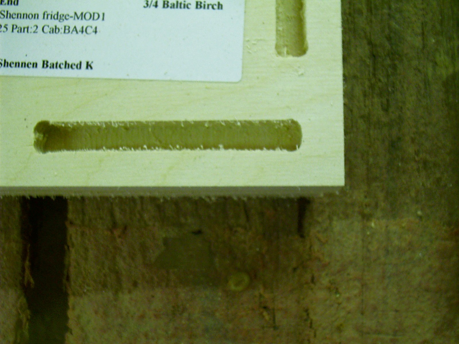

Currently the blind dadoe is giving us the worst trouble. I have drawers designed using the blind dadoe as well as the cabinets and assemblies. The kitchen is fairly customized and I have pulled from almost all areas of the program to design it. Part editor, stretcher editor, edge band editor, etc... I have hit a bug in almost all areas of the program on this job. Now that I have rebuilt the same cabs a multitude of times (to shake off the bugs) and it's finally getting nested the machine is milling the blind dadoes very poorly. The material thickness of the sheet stock that was run could not be adjusted for because some of the part editor cuts caused the program to default back to the original material thickness. Then there's the issue of the dadoes....
Dadoes are being milled much longer than the tennon length. About 3/8 inch past either end of the adjoining tennon . Tennon thickness is 1/4\" (50% material thickness of 1/2\" baltic birch ply set in construction parameters). Tennon shoulders are proud of the rest of the material. I will post images of what we have been getting.
Then there is the blind dadoes incorporated into the cabinets. Again at 50% material thickness, 3/4\" material. The results are off the chart and have to be seen to do it justice.

here's a couple nifty shots of a blind dadoe attempted in 3/4\" material

Forrest Chapman
Posts: 1261
Location: Anderson SC.
Post by Forrest Chapman »
Tim,
First picture looks like a flip op alignment issue. This is common with small flip ops in that its difficult to get them to hold in the perfect location. If the other end is cut slightly deeper thats your problem. If both ends are the same then its your tool size in the tool manager.
Second picture looks like your adding holes for KD fittings into your blind dado areas. I can tell you they have had issues in the past with this but they were resolved. Maybe something came back with build 3.
Third picture is easy fix. Cut in conventional direction. This may fix your first problem as well.
Forrest

Thanks for having a look. I appreciate all the advice that has been offered here. The problems that I'm expierencing on this job are too numerous to believe. The first picture was not a flip but a blind dado. The second and third pics are of the mortises in the 3/4\" stock. The large half cut-thru circles are concentric with a 1/8\" pilot hole created in the part editor. The idea was to glue the joint, assemble, screw the box off and move on. Only problem has been the software. Definitely not a KDA.

Your massa cabinet 003 pic with the big holes over the wot looks like a 3mm hole is the same prob im having @ the mo. Ive sent a email to thermwood about. I have to edit the code for this to stop happening. After its drilled the 3mm holes in the code it goes for (in my case) T1M3, a 10mm cutter and in the code it says \" pocket clean up\" and goes back and does those big holes over the 3mm holes @ the same depth as wot your dado depth is. This only happens when you add a 3mm hole with part editor.
Hope this helps a wee bit. and i know how annoying this prob is!

It sounds wrong but I'm glad you're having the same problem. Now we know we're not crazy! Thanks for the tip. It sounds like I will have to remove all those holes from this job. I'll put it on the list of things to do.
