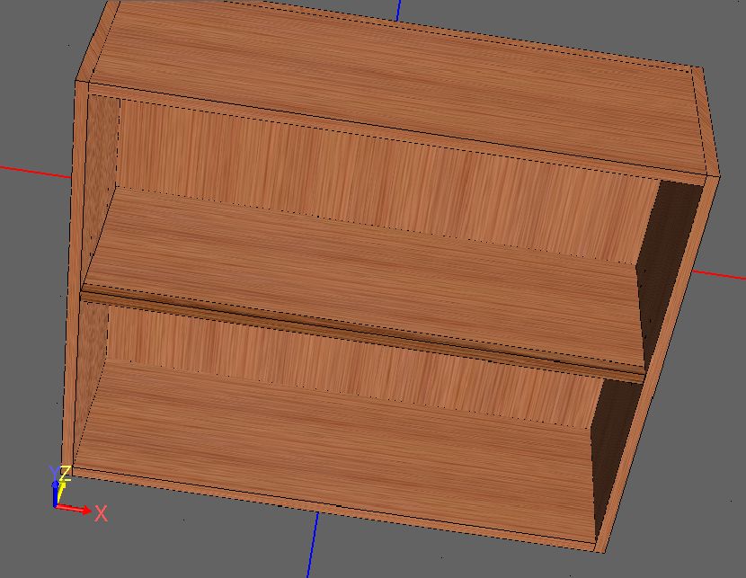

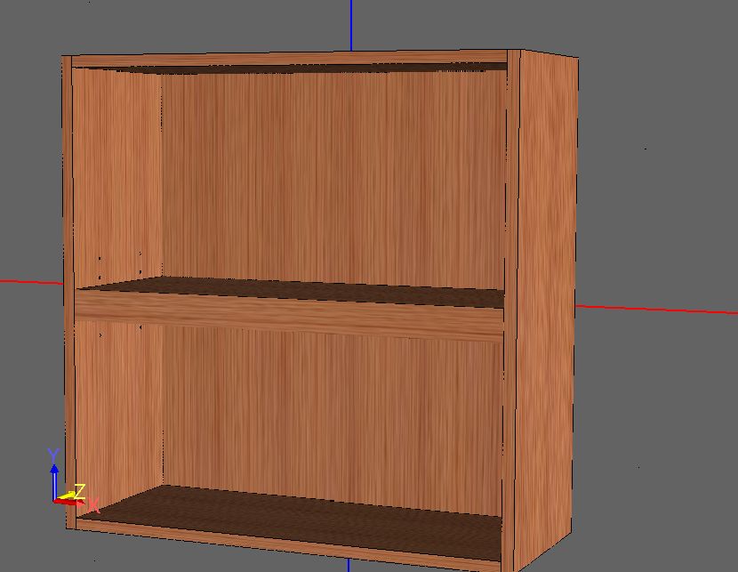

Hi Jon, welcome to the forum. The problem with using a display part is that it won't resize with the cab. Using a stretcher will resize in width but if you need to move the shelf up or down you will need to move it manually. The edge banding works with wide stock but the program displays it as flush. It does however show up on your cut list correctly. It will also move and readjust too. To have the correct dimensions for your miter you will need to give the shelf a 3/4\" negative front inset. HTH
shelf edge.jpg (56.85 KiB) Viewed 5553 times

Thanks! I played around with adding a stretcher. Seems to work good enough. Maybe someday a little checkbox will be added to the edge banding editor to create non flush edges. Seems like that would be a LOT less tedious. Pictures were helpful. Thanks again for the help!
