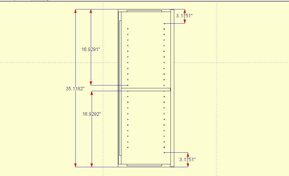

Sebastien -- It is easy to do. All you have to do is change the height of the top or bottom opening to get the holes equal. Take your cabinet to the LDE and check the distances to your holes and then add or subtract half the distance that it is out. Here is a pic.

Wally, I tried that and it works fine but I need a way to get around this without offsetting everytime I change the height of the cabinet or add shelves etc...
I just want to stay away from making more changes to my library cabs since I already have enough as it is, i'm also taking into consideration training on this system, i'm trying to keep it as easy and simple as possible.
Thanks for the post though!
