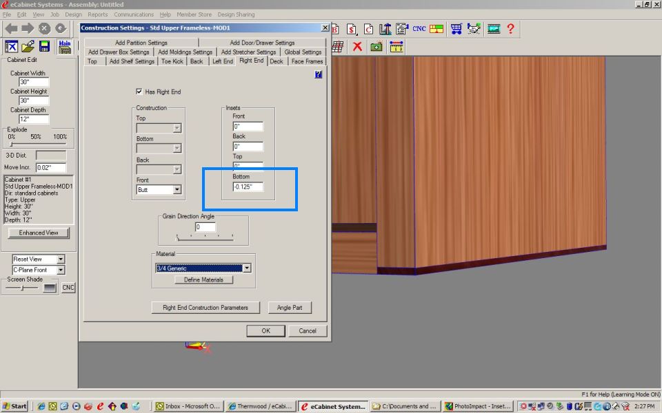

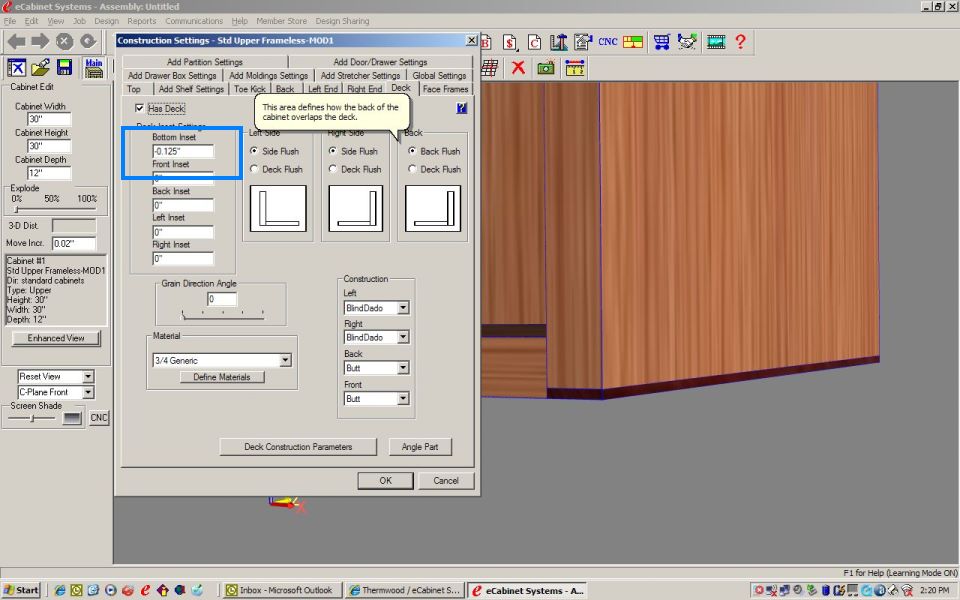

I wonder if this is correct? I inset the bottoms of the end panels and the bottom as well by 0.125\".
Inset for EB.jpg (74.78 KiB) Viewed 13853 times
Inset-right side.jpg (68.53 KiB) Viewed 13853 times
Al

Roger Kirkpatrick
Posts: 113
Joined: Fri, Jul 08 2005, 2:25PM
Company Name: The WoodCrafting Company
Location: Hesperia, California
Post by Roger Kirkpatrick »
If you use a negative inset the side will be longer not shorter.
You want a positive inset on the bottom of the sides only.
Leave the deck where it is. This will change the size of the cabinet.
This way the cabinet is flat on the bottom and the edgebanding is not sticking below the deck.
But as was mentioned, if you go into edgebanding editor and add edgebanding to the bottom of the sides and your edgebanding is set to the right thickness (with the glue) all this will be taken care of in the software.

Al Navas
Posts: 443
Post by Al Navas »
Thanks for setting me straight, Roger.
I was puzzled at first, because it was not working properly on the example I posted. NOW, without ANY insets, the sides stay at the desired length, and the edge banding is flush with the bottom of the deck. I must have had an inset, somewhere. Just cannot for the life of me figure out where :? , and cannot reproduce what I did earlier.
