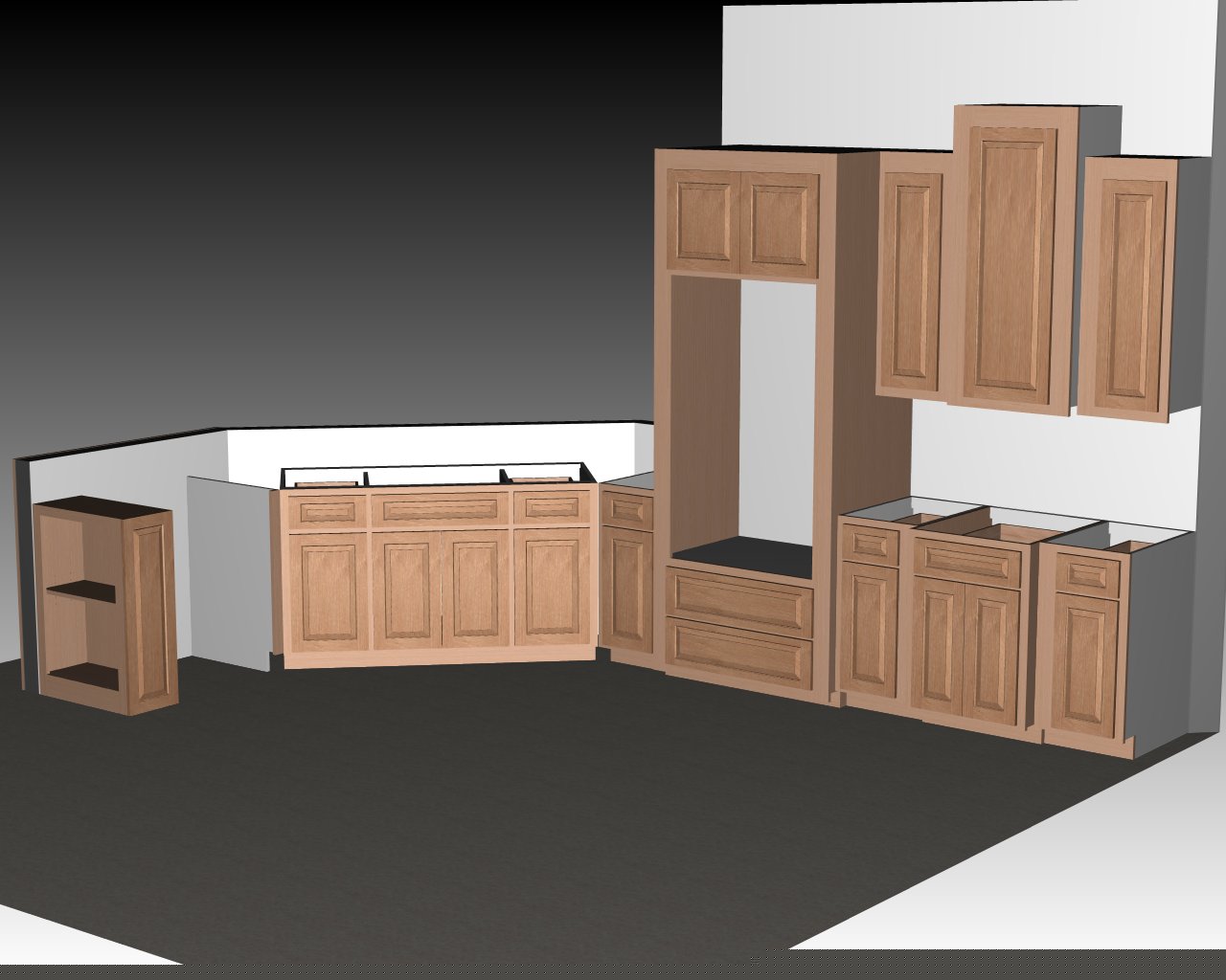

I have just finished the preliminary design for a kitchen I was asked to bid on. Up until now I have not done anything of this scope before. Luckily E-cabs was a great help in determining exactly what I needed in terms of materials, etc. It was also my first 'real' project done in e-cabs and though it is not perfect, I thought was pretty close for a first attempt.
Now comes the hard part, pricing my work. In the past, pricing has usually been on a per piece base. I am having a problem pricing my work on something this large, make a profit and not have the bid up out in left field.
There seems to be a few different thoughts in pricing.
1. know exactly how long it will take to machine, assemble, finish, etc. and multiply hours by a hourly rate.
2. take total material, multiply it by some percentage. (materials x 2 as an example.)
3. a set price per foot
So here comes the question...
Any thought on what is the proper way to price?
I will attach the e-cabs file. Take a look at it, let me know how you would price it. That may help me figure out what to do.
The details...
cabinets in rustic alder
42\" uppers except for the bump ups
angled, fluted returns on bump outs.
Conestoga CRP-10 in rustic alder
dovetail boxes - outsourced
undermount slides (customer wants just a standard bb slide but the upcharge to undermount isn't much)
finished exterior face of peninsula, corbels, etc.
customer will supply stain, I apply and finish
Thanks in advance for any assistance, advice, etc. that you can provide.
