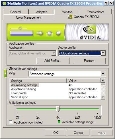

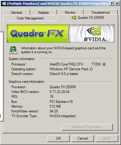

Dean,
The Tweak Utility goes to 4X anti-aliasing. I attach images of the range available in my system. Would using anything higher than 4X simply slow down the system?
Edit to add: I set anti-aliasing manually. I wonder if this is OK? The laptop speed did not change perceptibly. Renderings are still VERY fast.

Al,
Beyond the 4X anti-aliasing on the Quadro FX 2500M graphics processor, you see what's called 8xS and 16xS, which (I believe) are \"Supersampling\" anti-aliasing techniques. These \"higher\" settings are actually of lower quality, IMHO, because of the technique used which makes the image seem fuzzy.
To enable the slider bar in the Control Panel applet, you must first \"uninstall\" the Tweak Utility to return control of eCabinet Systems to the nVidia Control Panel Applet. The Tweak Utility will supersede the manual settings for eCabinet Systems as long as it is \"installed\".

Thanks for the explanation, Dean. What would we mere mortals do without the experts like you folks???
To paraphrase what you stated, and so I won't get it wrong: The Tweak Utility IS the way to go, to avoid adverse effects from manually setting the anti-aliasing stuff improperly.
