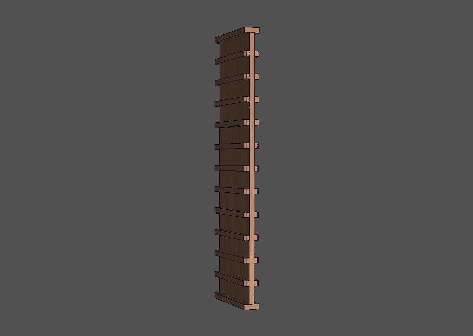

Wine Rack
Michael
Here a Cabinet that I made up
You can play with this if it will help you
It is one cabinet with part's
Cab size 36 x 72 x 16
Wine Rack.zip
(1.28 MiB) Downloaded 2171 times

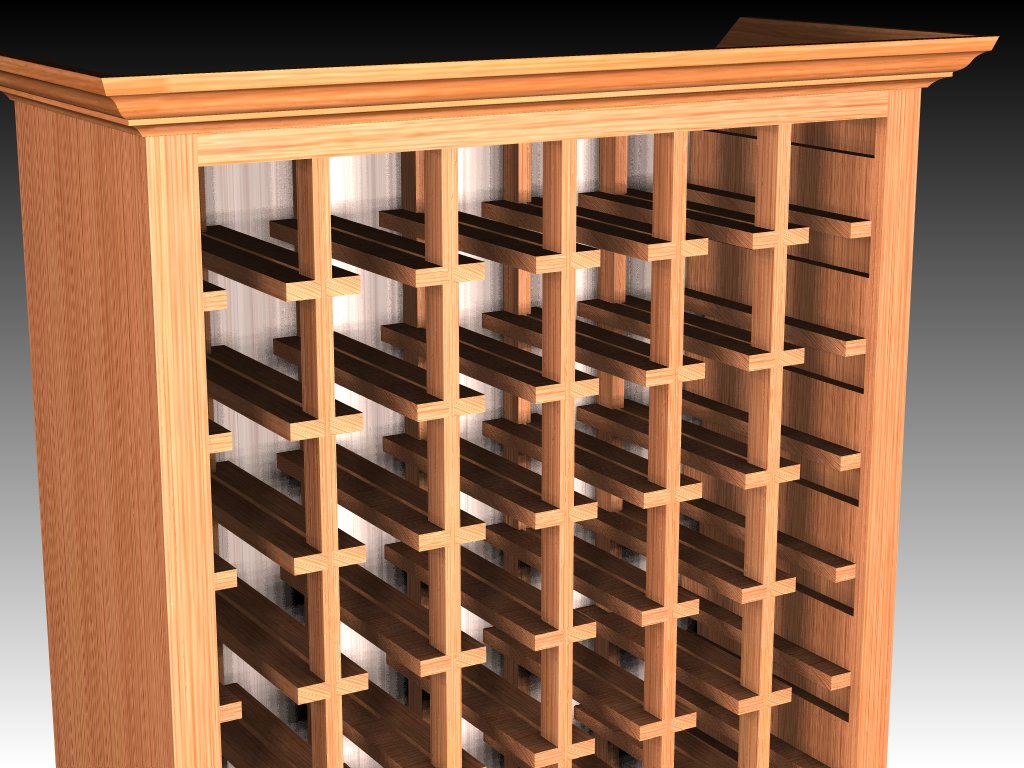

Michael Rice
Posts: 199
Location: Madison Ga.
Post by Michael Rice »
George
This is how I built my single bottle racks. I used a 1 x 2 at front and back instead of a solid partition. Do you guys use solid partitions in your actual cabinet, or did you just use the solid partition for your renderings. I made 1, then copied and pasted the other 2. Seems like a pretty fast way to render the racks. Thanks for all the help.
Mike
Wine rack.jpg (70.31 KiB) Viewed 42476 times
Geart idea Mike
I us solid partitions in my actual cabinet that way it will come out
in my nest print out.
I cut out the solid partitions down to 1 1/2\" front and back
Thank You Mike
