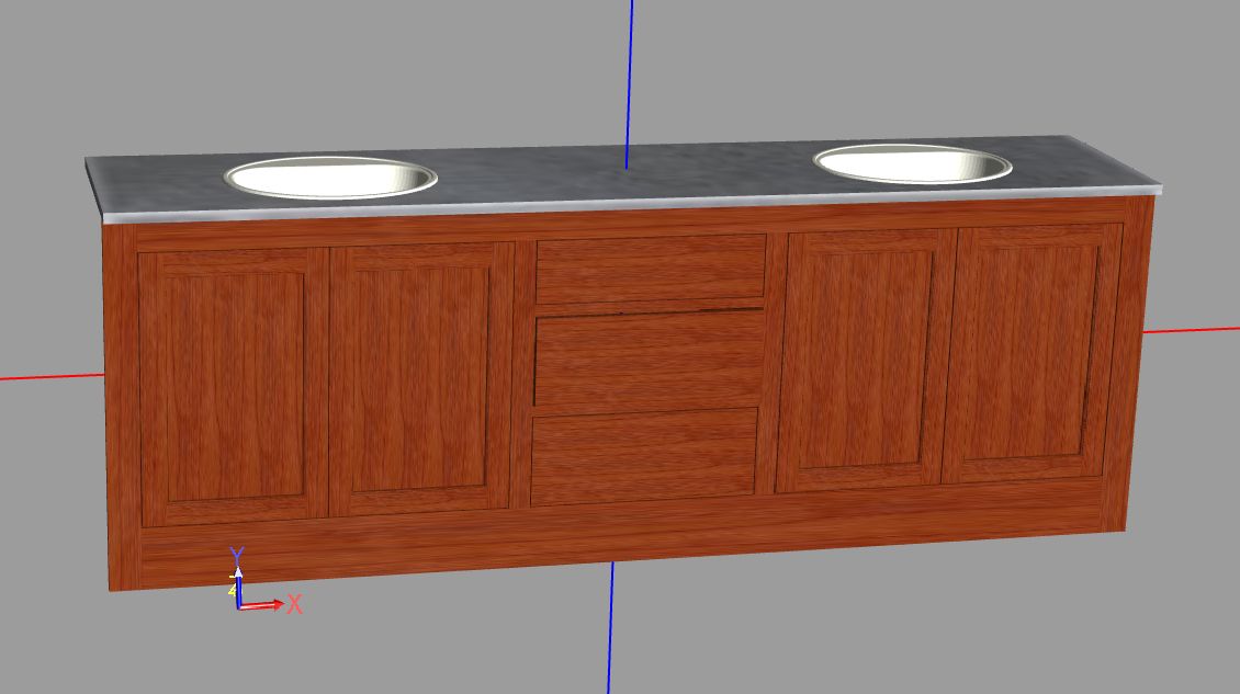

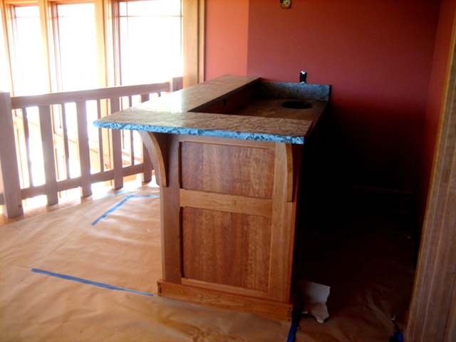

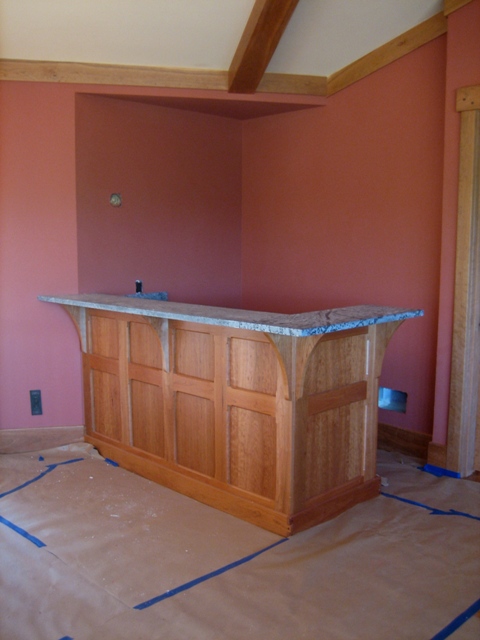

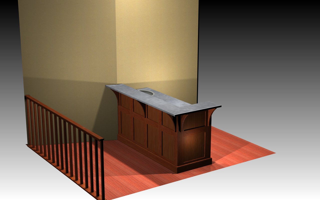

These pics are from a job I did this past spring. The house is still under construction as you can see, but i had to go to there yesterday so I took a few pics. This is an arts and crafts home in the style of Greene and Greene. Another company did the kitchen, I did all the baths, sauna, bars, bookcases, and a variety of millwork. For some of the cabinets i used eCabs just to get my dimensions, layout, and sheet good count. these pics aren't very good but I'll get better ones when the house is clean and finished

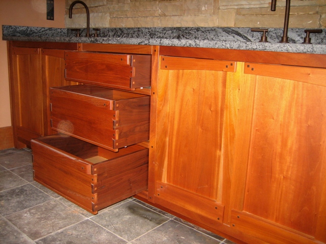

African mahogany sauna vanity........anybody see my signature :oops:
walnut and mahogany finger joint drawers

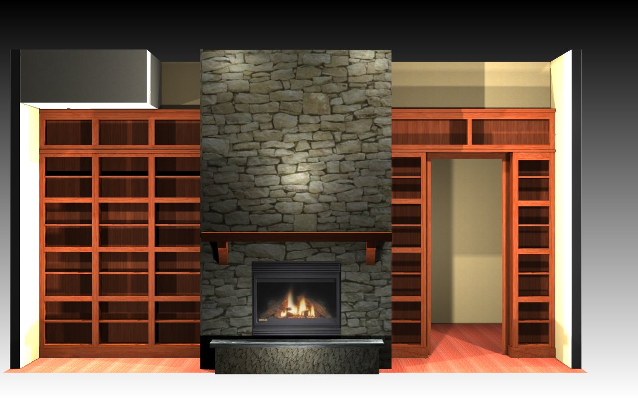

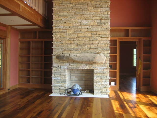

Some of the many bookcases

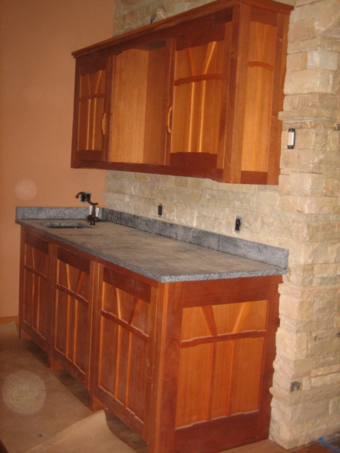

Mahogany wet bar. Owner wanted frige and icemaker completely hidden so I made large panel doors to hide the appliances. The space behind the bar is storage so we cut the wall out for good airflow around the appliances.

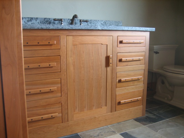

Small guest vanity

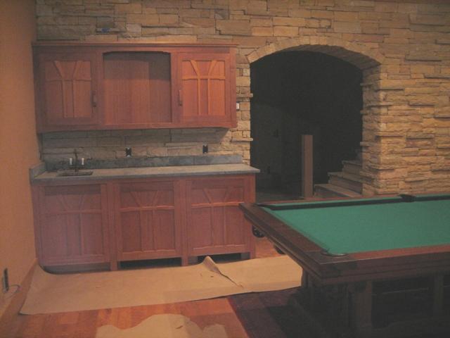

On the pic of the bar, what kind of top material is used? Pretty cool house, I like the rec room. Is that a soap stone top in rec rm?

The tops are all soapstone, kitchen, baths, bars...everywhere. Owner loves the stuff. It is beautiful in it's natural state, but it is very soft and porus. It sands and cuts about like wood. It's not widely used here in north central Ga. What I don't like about it is that it has to be treated with mineral oil several times a year for a year or so. This turns it black with the white streaks showing through. I don't know if it's treated this way in all cases or not, but that is what this guy is doing.

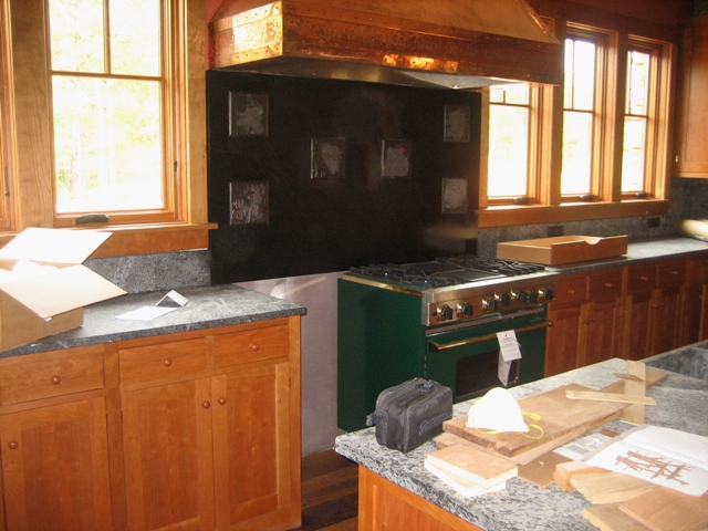

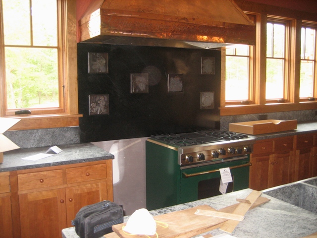

This is my first experience with it also. I can tell you for sure that the oil turns it black. My owner bought his backsplash, above his stove, from a guy who did some inlay work in the soapstone. The material they used has already been treated with min oil, for a while, and it is very black. I hope your owner knows how radically different it's gonna look after a few treatments. Plus, the oil makes it greasy....

I stopped by this job today and snapped a couple pics of the treated soapstone. Pics are kinda lously due to the back light but you can get the idea of how different the treated soapstone looks. the backsplash has had a number of treatments ( i don't know how many), but as you can see, it has turned very black. The counter to the left and in front are still in the natural state. As you know, mineral oil doesn't cure, so the treated backsplash has an oily feel to it........personally, I wouldn't have it. Too much maintenance !

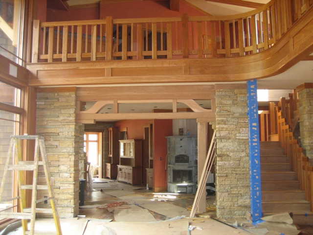

Soapstone pizza oven.....for the man who almost has it all. I wish i had a close up, but that's it to the right thru the opening.

Wow. Not everyone has one of those!
