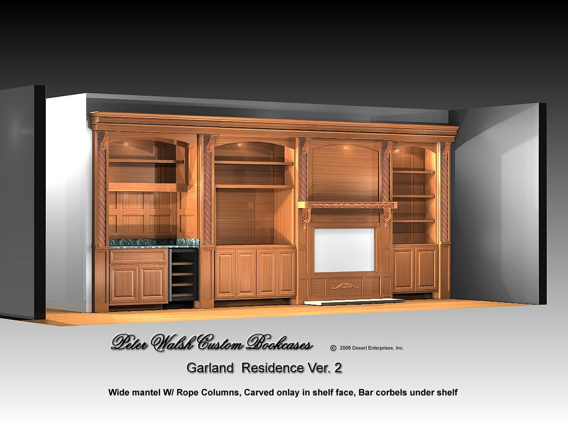

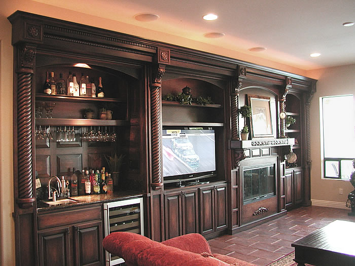

The old-world Spanish media wall I posted in January is finally done. The eCab rendering and the finished site photos are shown below.
The wood is all Cherry. Finish detail steps: Pre-sealed with wood conditioner, Old masters Oil wipe on stain, polyurethane sealer coat, dark glaze, final polyurethane finish coats. there is some ocasional distressing but not prominent, mostly \"shop rash\" not repaired.
The site was a brand new home with three existing alcoves and fireplace.

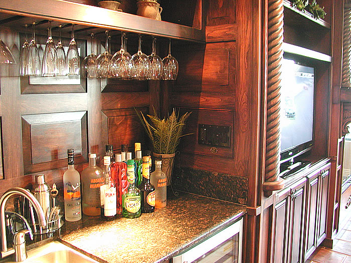

There is rope light in the soffit for a soft nightime glow. Top cabs have rope light also. Bar detail shows lift-up door hiding the wine glass slides and customer-chosen location for the engraved maker's lable right below the light switches.
Fireplace is gas-log type.
Soffit includes both dentil and rope-twist trim to match columns.

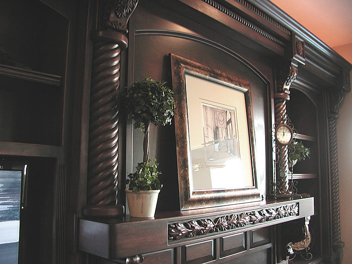

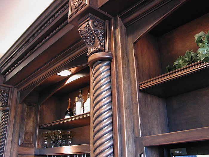

Here is two more detail shots of the finished project.

Thanks guys. It was a long project and some parts took much longer than expected (doesn't it always?).
I use an HVLP (Turbonaire) spray system to apply the poly. Usually, I make all the sub coats gloss, and the final coat semi-gloss or satin.
Undercoats in gloss lets the grain show through clearly rather than multiple coats of satin which gets muddy with successive coats.
The glaze color is called Asphaltum. It is a water based semi-gel and is totally black in color. The customer wanted me to match an existing piece of furniture he had which had an old-world Spanish finish with a black glaze to simulate decades of use and wear. The color match turned out exact which is rare since I had to mix two stains to get the right under shade. Lucky.
The glaze was problematical for me here in the desert since it dried quicker than it may for most of you and I had to work very quickly...apply, wipe down, and dry brush to feather. Lots of muttering on that one. Got paid extra for my trouble though.
