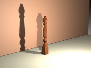

Brian Shannon
Posts: 979
Location: Los Alamos, CA
Post by Brian Shannon »
This is an Osborne leg that I converted. It shows nicely.
Cliff Final 2.jpg (191.1 KiB) Viewed 13634 times

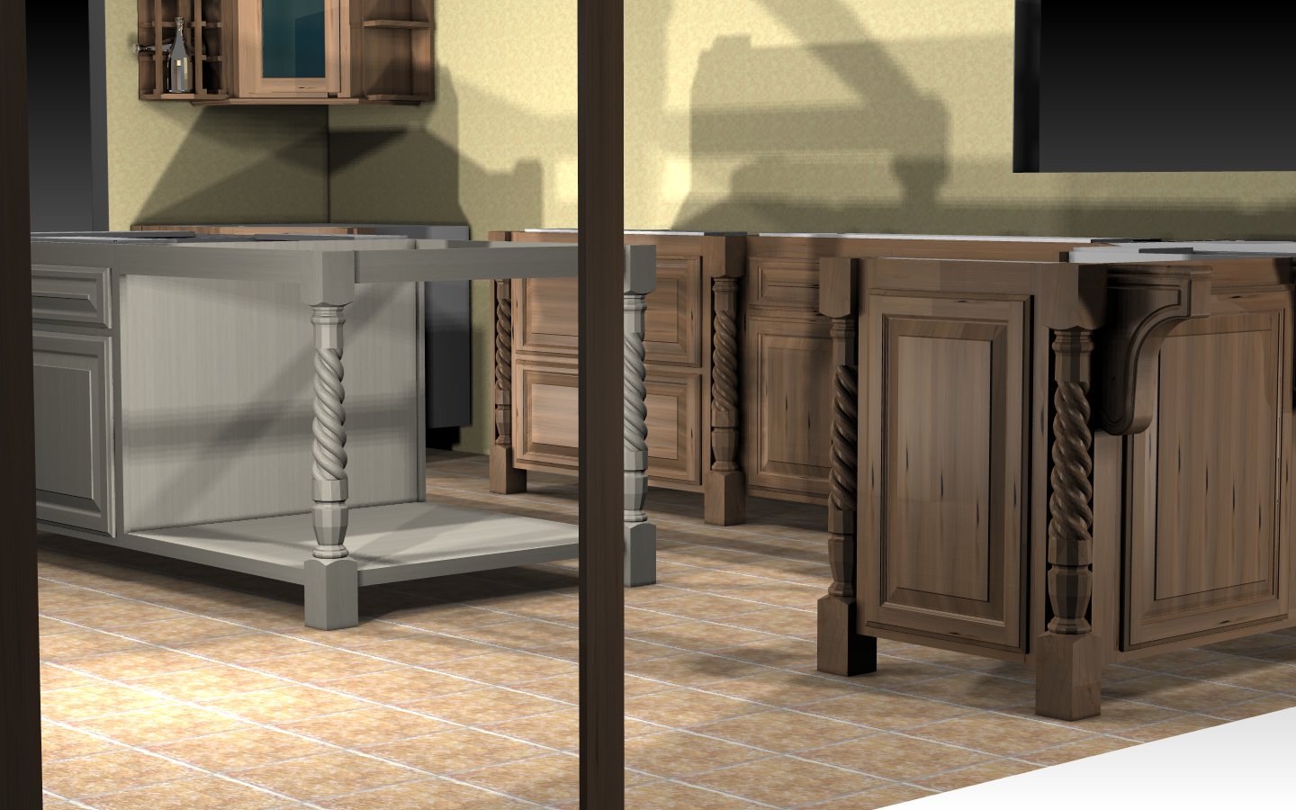

Joe Dusel
Posts: 1117
Location: Vista, CA, U.S.A.
Post by Joe Dusel »
I also converted a few of the Osborne island legs which I used on a project I'm working on. They turned out pretty good. I just placed and order with them yesterday and thanked them for providing the drawings which I mentioned that I used within eCabs.

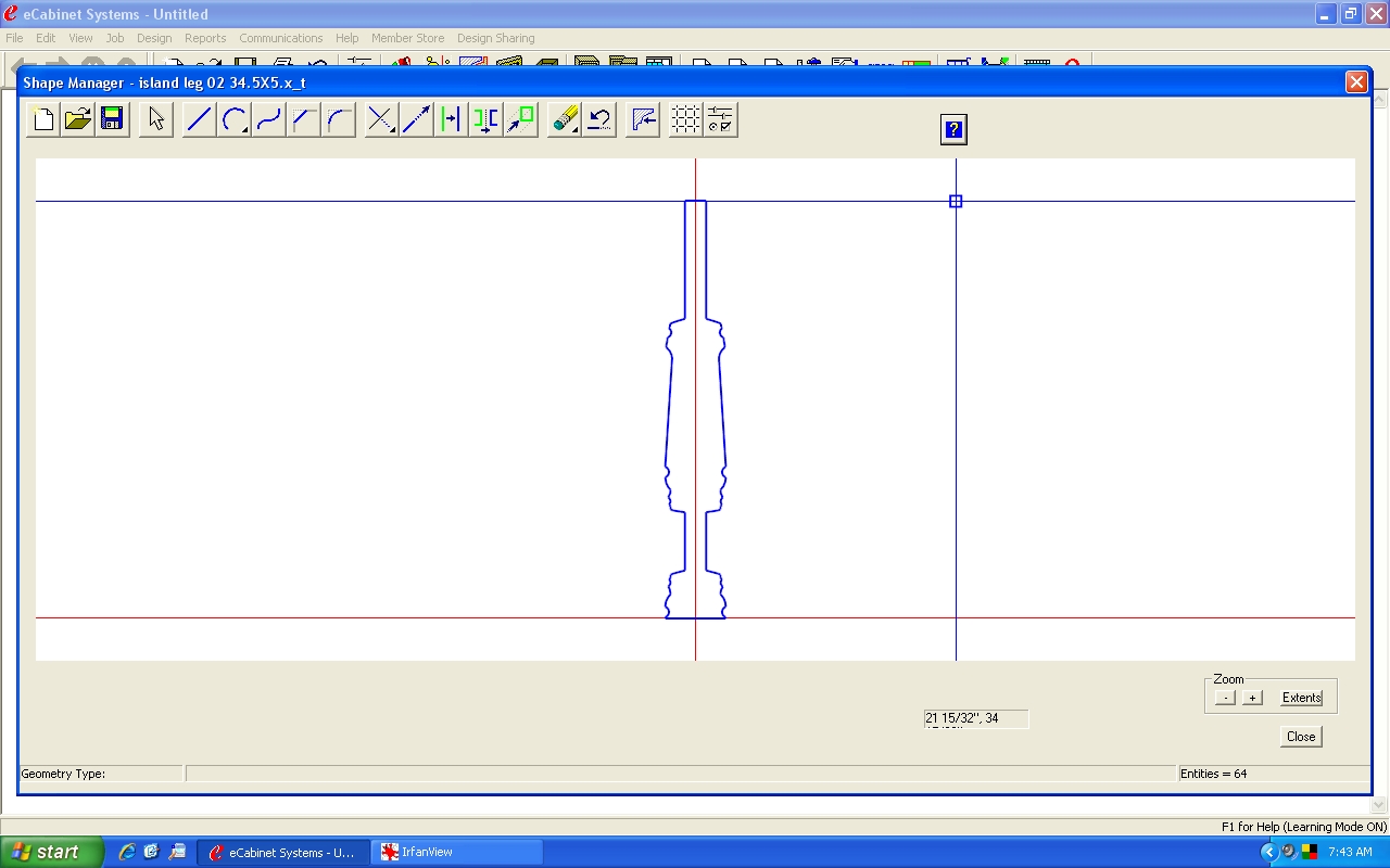

Al Navas
Posts: 443
2D CAD files to STL
Post by Al Navas »
I am having trouble converting the Osborne Woods 2D **.dxf files to STL, prior to converting them to a tool. I am using Accutrans 3D to attempt the conversion.
Accutrans works fine for the 3D files, but I have had no luck with the 2D files. I would appreciate any hints and suggestions on how to do this conversion. Accutrans does not report any errors, it simply does not write the file when I save to the import folder in the eCabinet Systems folder.
Thanks!
Al

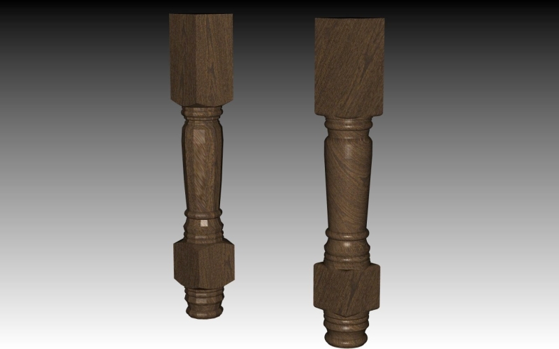

Al,
You bring the Osborne 2D .dxf file into the shape manager where you delete some of the lines and use the Move Tool to turn the profile \"Inside Out\" so to speak. You then add the deleted lines back in to create a closed contour. You may also have to use the extend and trim tools to connect many of the segments to get a closed contour. Some of their drawings are created from many segments. For those I just use their tool as and outline to trace a new tool then delete the original to eliminate some of the segments.
Here is a screen shot of one of the tools created from an Osborne file.
The first leg in the picture is rendered view of the Osborne 3D file converted to .stl and the second leg is one created in eCabinets using the tool I created. You can see the difference but as I said it is a lot of work to get there.
