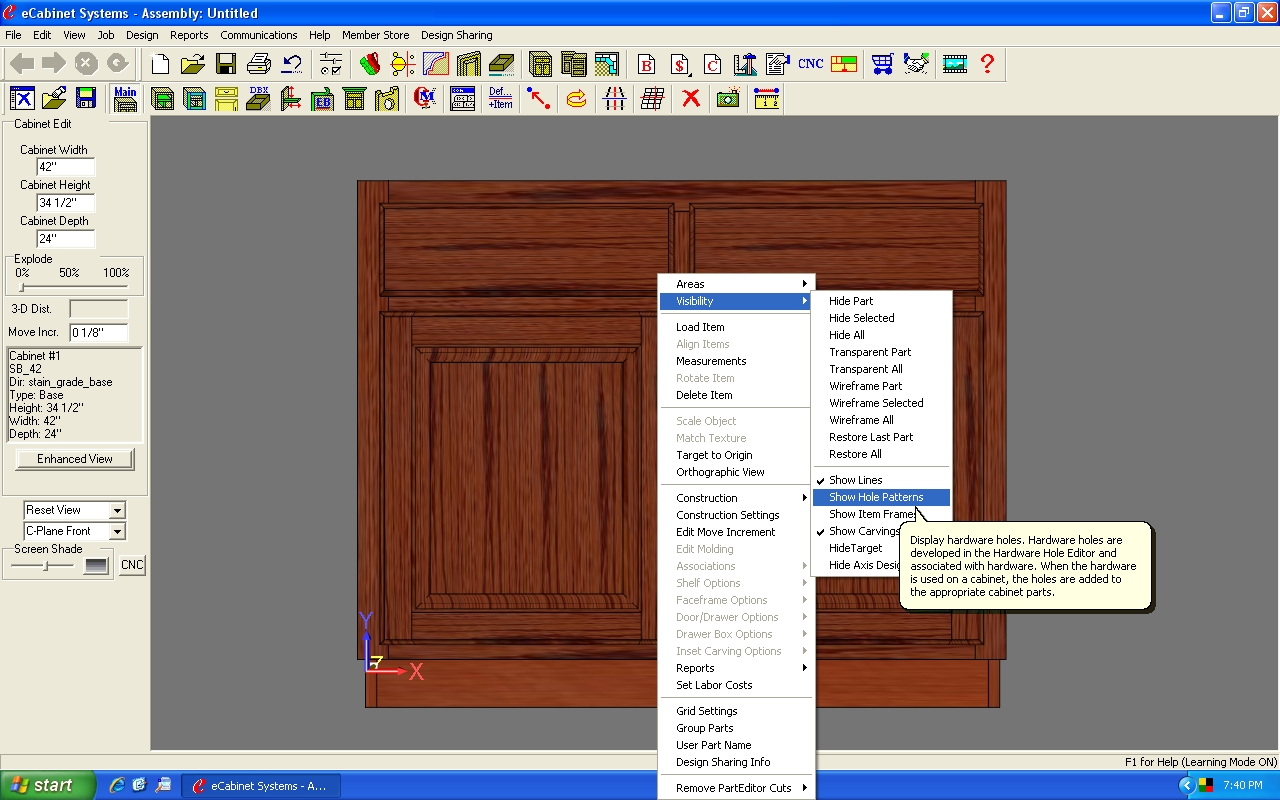

Gene,
In the Cabinet Editor right click, mouse over Visibility and make sure you have \"Show Hardware Patterns\" checked.

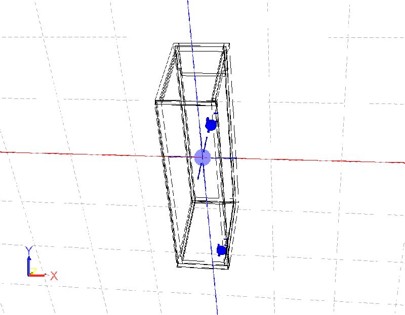

Got everything working for drawerslides, but hinge preps are a new problem!
Door default is chosen from a Conestoga pattern, I associated a hardware prep (door holes and cab holes both in prep) with both hinge and hinge plate, set hinge and plate as default, installed doors, and there are no preps in doors. See attached.
Also, the cab holes for the hinge plates show in blue. What is that about?
Why no door prep and why blue.jpg (88.95 KiB) Viewed 3169 times

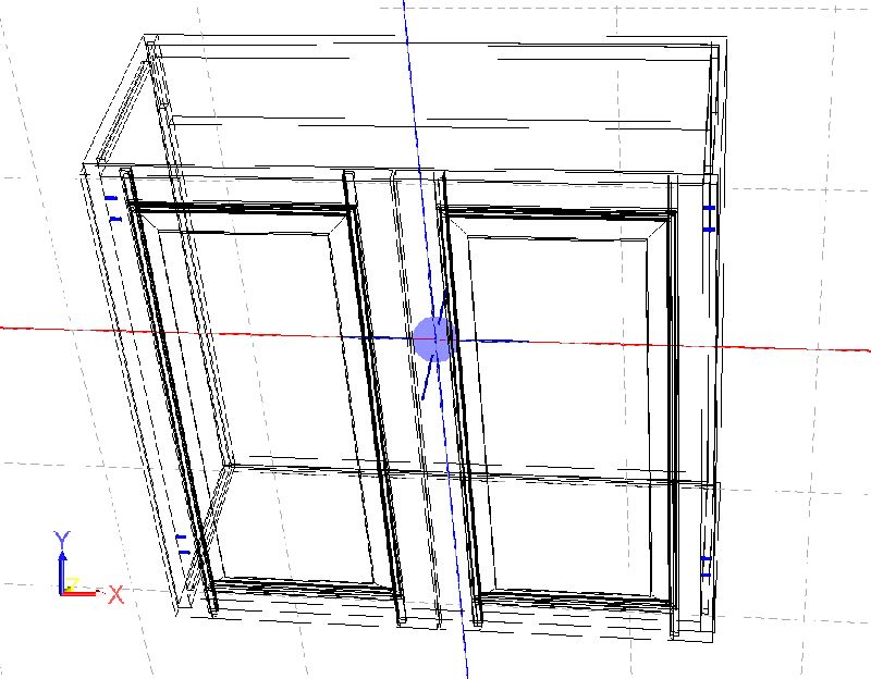

Gene Davis
Did some more tinkering
Post by Gene Davis »
And it seems that DOOR hinge preps (35mm cup hole and 8mm dowel holes) will model and show for a SLAB door, but not for a Conestoga door.
What's up?
Why slab door prep but not Conestoga.jpg (49.97 KiB) Viewed 3154 times
