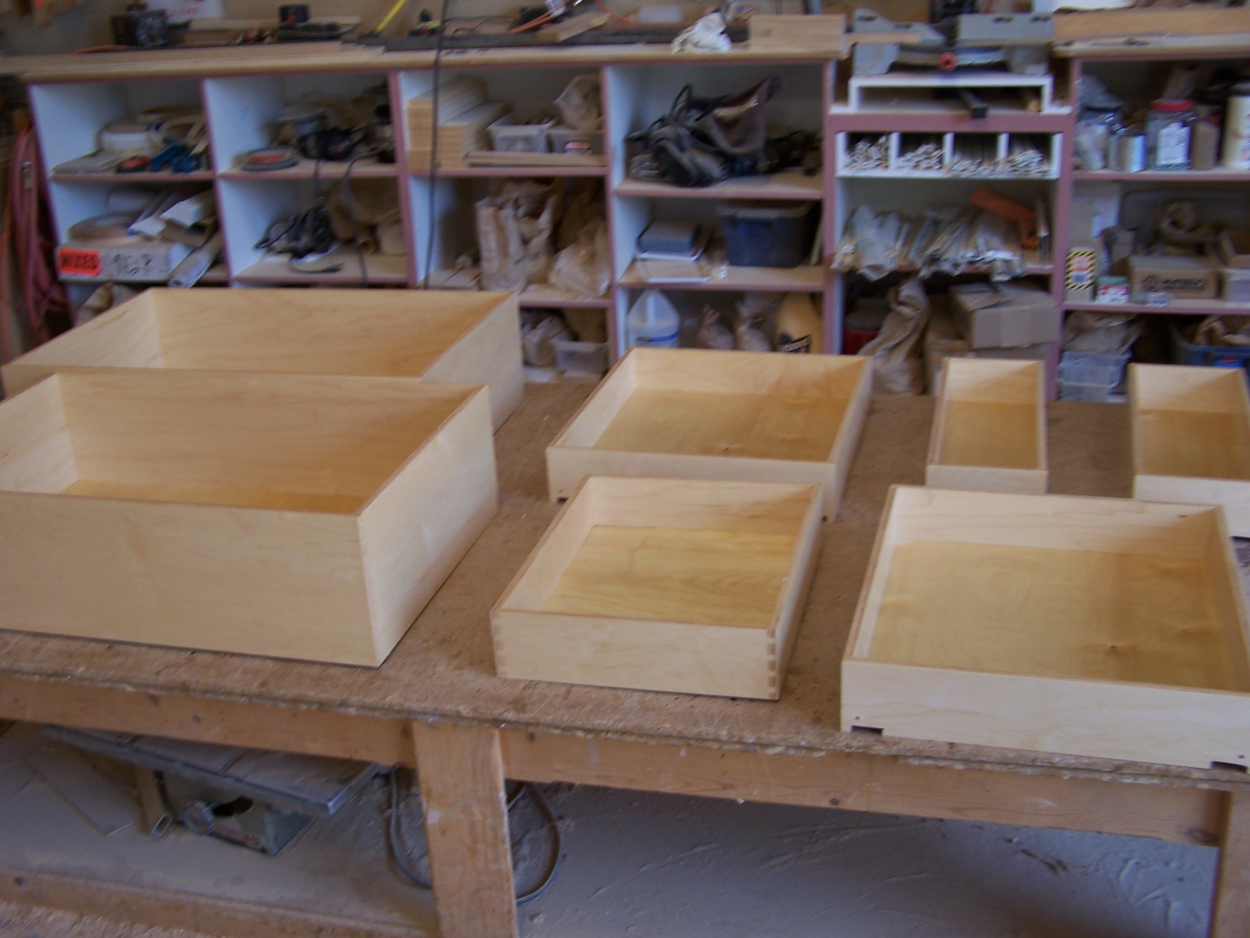

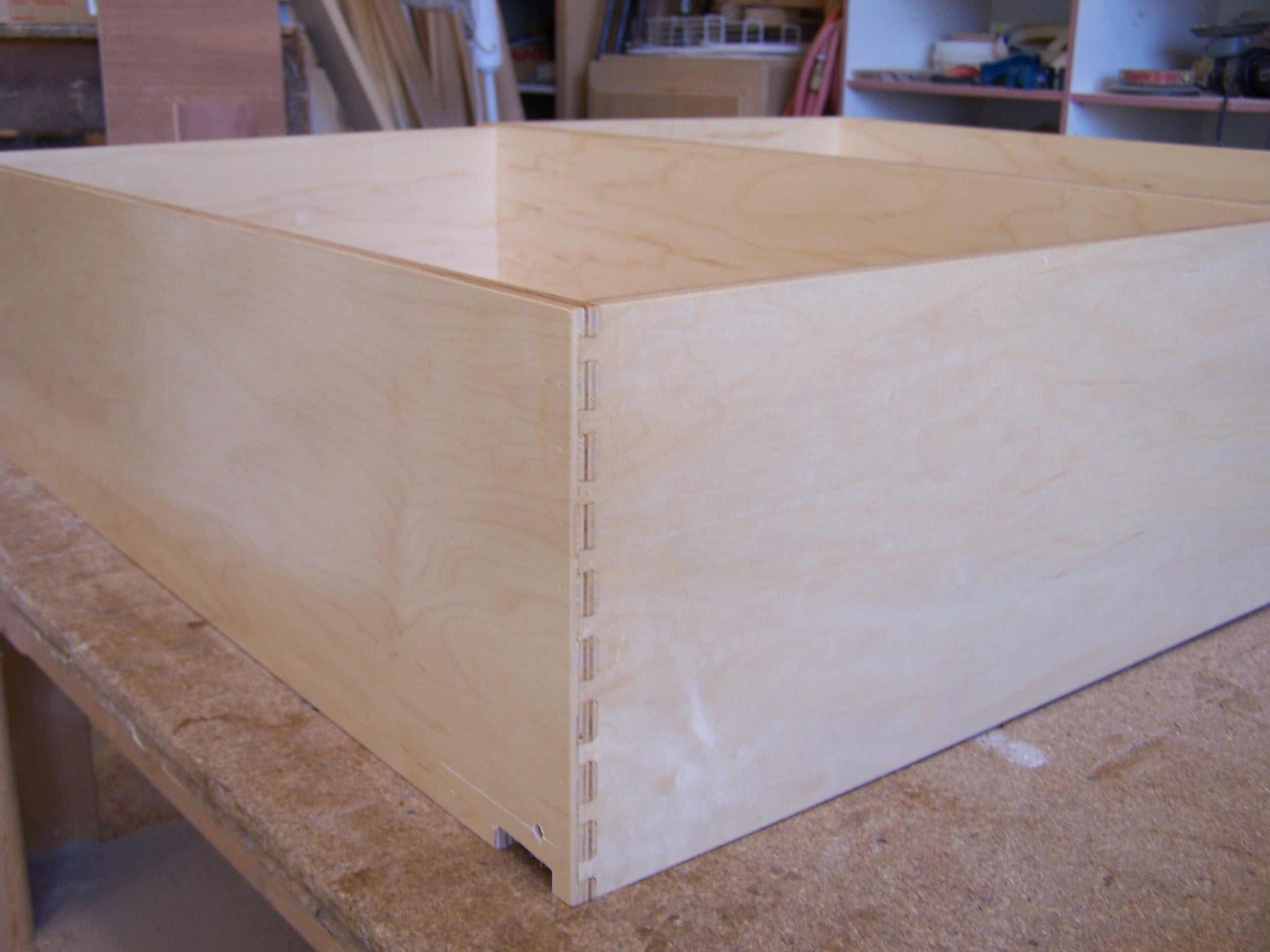

I was also hesitant to get into the dovetail boxes and didn't have time to experiment. Recently, I had success cutting a small batch of drawer boxes from 1/2\" ApplePly. I need to get them a little tighter but am very happy with the way they turned out.

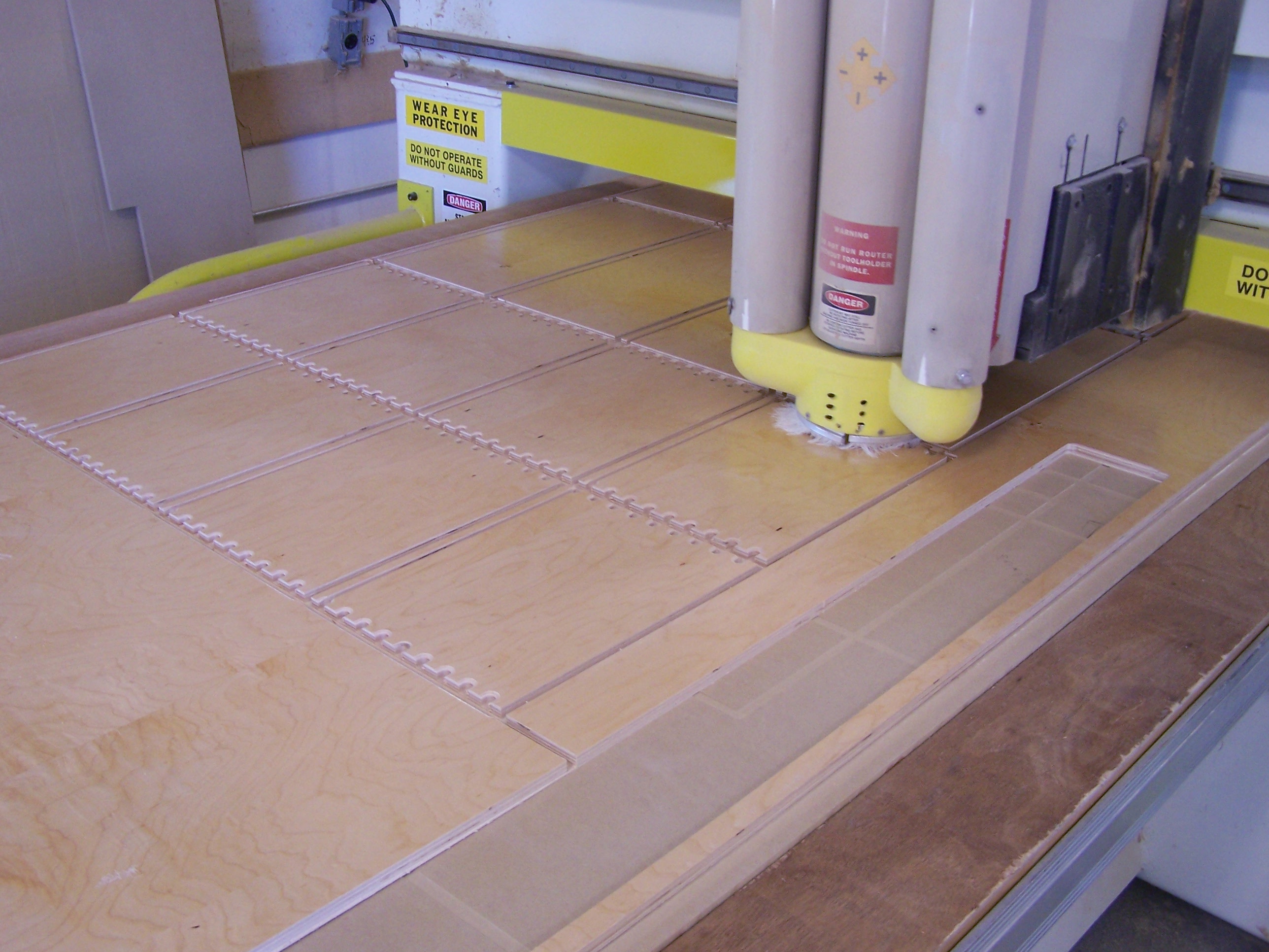

cut the first couple dozen for your own use and experience then dont look back. I have mine tuned in and have cut a couple thousand, very few problems.I tell you one thing I do that might seem strange to some, but I take off the dust shroud and turn off the dust collection. does not seem to affect the cut and I have not had a part move on me for a long time. I use 5/8 baltic birch or every so seldom solid maple.

The notches and holes were done by hand. I would like to try the PlyBoo. In 'Vegas, I saw some at the Hardwoods Booth. I also liked the Totally Bamboo countertops and backsplashes. They aren't cheap but different and \"green\".
