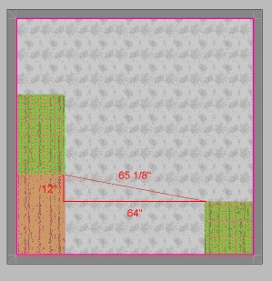

Okay Okay, I know I have been a basher of ecabinets on some issues but I do also applaud the things it does well. I have recently discovered how to exact position two cabinets in the middle of a room. I selected a cabinet and adjusted something on it and moved to the next cabinet and selected it without deselecting the first. To my amazement it told me the distance between the two. It was the answer to another problem layout I was struggling with. I actually felt like standing up and cheering.

It also works on cabinet to wall distance.

I know, ain't it great. Somethings are just wonderful surprises. Thats what keeps me going. The golden nuggets you find in the field of rocks.
