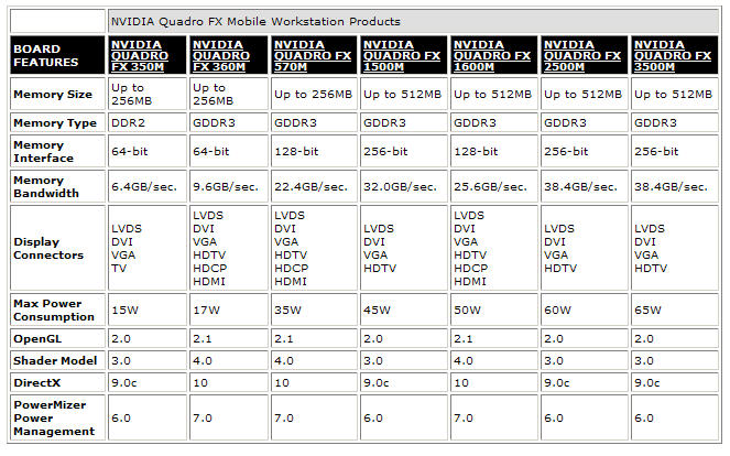

I took the leap and ordered a Dell M90 with the FX3500 on the 16th/07. Well I am still waiting and it is sitting in pre-production. The hold up I think is the card, They promise 7 to 10 days delivery but once they got your money they set any time they need! When I finally get it I will let you know how the thing runs eCabs with a 3500 card. the rest of the machine is recommended spec with a 2.0ghz processor.
The nVidia website has a comparison chart for all of their GPUs. According to the chart there is no difference in specs between the 2500 and 3500 as far as speed and performance.
The only differences shown on Dell's website are graphics clock speed (575e/600m for the 3500 versus 500e/600m for the 2500) and power consumption (70 watts for the 3500 versus 65 watts for the 2500).
Both have 512MB dedicated RAM so video memory is not an issue with either card.

Dan, besides the obvious like they just want to make more money, why is there a price difference between the 2500 and the 3500 if they are the same?
Re:
Nick M Singer wrote:Dan, besides the obvious like they just want to make more money, why is there a price difference between the 2500 and the 3500 if they are the same?
:?: :?: :?: They do have a different GPU and the 3500 is a little faster than the 2500 (according to Dell's specs). Looking at Dell's site, the 2500 adds about $250 USD and the 3500 adds about $950 USD to the price of a new M90. Personally, I don't think there is enough of a performance difference to warrant the big price difference.

So to interpret this googamagig the money is best spent in memory. You can not go wrong putting in more RAM.
My opinion is that if you are on a budget and are looking for a computer to handle the performance; you need the recommended 2Gig processor and RAM of 2Gig.
Second is to use a PCI card and not the standard cards. The performance is dramatically different.

Dan , thanks for the claification on the 2 cards, I will go with the FX2500 and go with more memory (4 GB). Michael, correct me if I'am wrong, but the M90 has 2 slots for memory and if you get 2GB both slots are filled, than you replace them both to upgrade to 4GB. When I bought my new desk top 9 mos. ago, I asked a friend who is an engineer and works with Auto Cad about the Navida FX4500 card, and he though I was nuts to spend that kind of money , but I'am glad I did , as E-Cabs no longer crashes. Thanks to all of you,
