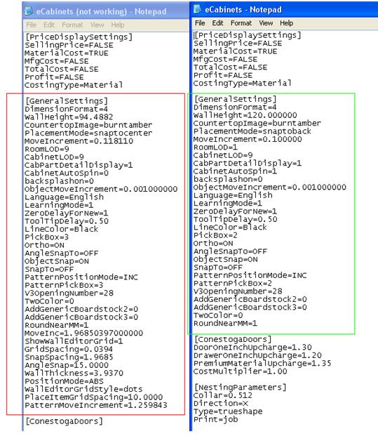

After a bit of experimenting I've found that the “eCabinets.ini” file
(found in your eCabinets main folder) was the problem, when swapping between the original install version of the file and my backed up version the Wall Editor also swapped between working and crashing!
The attached picture is of the settings that work (in the green box) and the settings that don't (in the red box). Not sure how these got changed to something that made the program crash. But if this happens to anyone else at least you'll know why!
The Wall Editor now works fine, and I expect if I did the same on my old computer the Wall Editor would start working again! -oh well.
-Calvin
Calvin,
Those settings in your .ini file are the values you enter in Preferences and are changed when you enter new values. I think the wall height value is changed when you enter a new value in the wall editor. Example: In the red box you had set your wall height to 94 1/2\" and in the green box it was set to 120 inches.
The ecab guys need to look at this though, there still must be some problem causing your crash.
In the red box, room level of detail is set to 9 while in the green box it is set to 1. This could be causing the problems depending on just what type of video card your computer has in it. Try with the settings that don't work and lower the level of detail to its lowest setting to see what happens.
