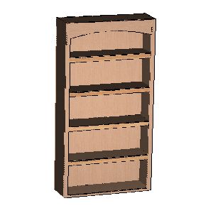

On the hopefully attached cabinet I have been able to change the top & bottom rail, left & right stile from Hickory to Alder. But the mid rails won't change. Is that a bug or am I doing something wrong?

1. go the Face frame editor
2. select mid rail and stile
3. go to face frame construction settings, change the mid rail/stile material
4. hit ok

Thanks Rick.
I guess that was it.
