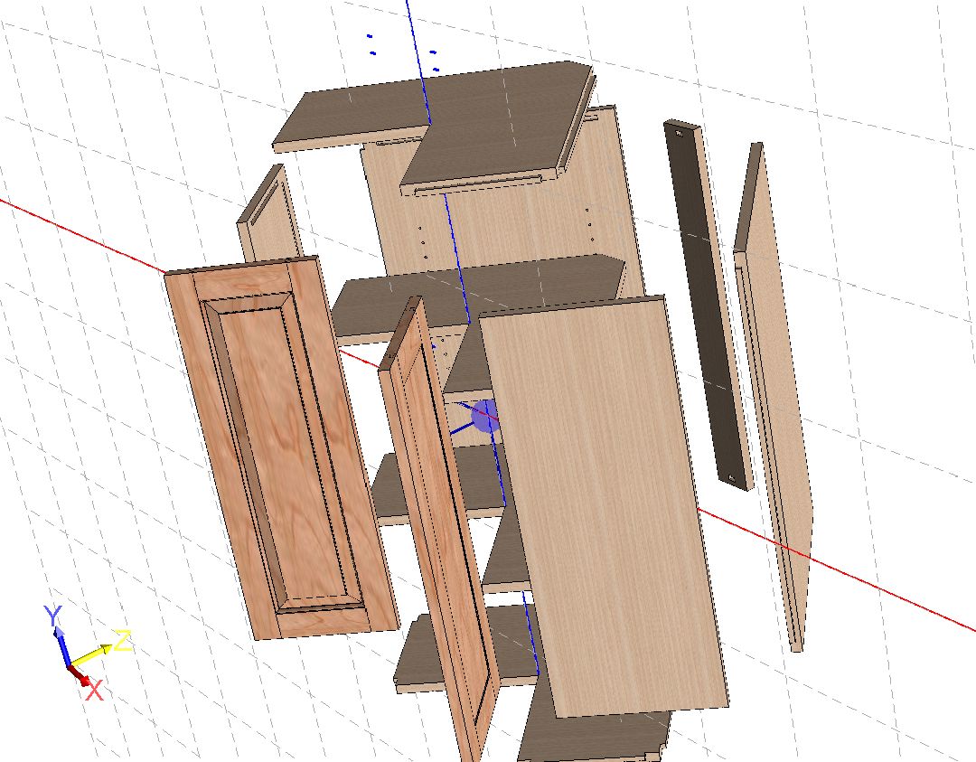

I am working the standard frameless seed, corner upper, and in adding doors and associating a hinge with associated hardware hole pattern, I am getting holes all by their little blue selves, up in space above the cab.
The same hole pattern has served me well in other cabs I've built.
I did a download from this forum of a basecab susan corner, that exhibited the same little cluster of David Bowie holes.
What's going on? Is there a patch for this?

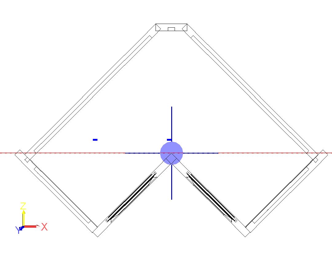

You can see their spatial relationship with the unit in the topview wireframe.

I wonder if you have graphics display issues. Have you rebooted recently?
Are these still out there after you reboot? I wonder if your graphics system needs a kick at this point. If not, I have NO idea about what is causing it.
Al

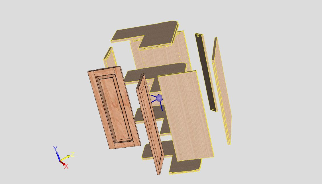

Here is the file. See how it displays for you.
Corner wall 24x24 piehinged doors LH 2 shelves.hsf
(578.02 KiB) Downloaded 612 times
Al Navas
Posts: 443
Post by Al Navas »
Here it is, Gene. I opened it as a cabinet, not an assembly (since the file suffix is *hsf, not *.esa). I don't see the hinge holes at all, as you will notice. Was this the correct cabinet?

Gene do not despair hole patterns in corner cabs continue to be an issue in eCabs and will be sorted eventually, it used to be worse I was getting the hinge holes in the doors drilled randomly into other doors so there has been progress

Kerry, I HAVE the \"show hole patterns\" option checked in VISIBILITY.
This cabinet is one made using the seed in the STANDARD file of cabinets that comes with the program, \"Std upper corner frameless.\"
The seed comes without doors, and when I place doors, using associated hinges for which a hole pattern is associated, I get the flying-in-space holes as seen and discussed here.

At this time you cannot associate a hole pattern to a corner cab. I take my ends into part editor and add manualy to both sides. This way it can be hung either way. Take the parts to constraint manager and constrain the holes to the top and bottom so you can stretch it.
