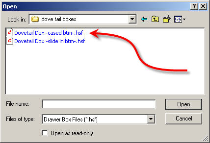

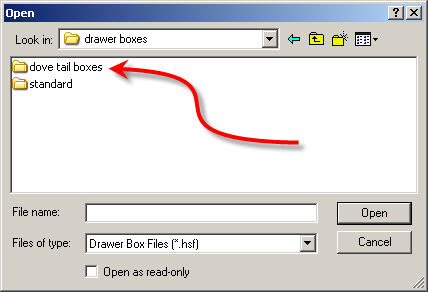

Look in the Dovetail Boxes folder instead of the Standard folder. You should have a cased bottom box there.

I stand corrected. I had misfiled a box in my PATTERNS folder, and had the drawer box editor opening that one first.
Here is the way eCabs 5.1 came to me with drawerboxes.
The folder \"drawer boxes\" has two folders within. \"Dove tail boxes\" and \"standard.\"
The folder \"dove tail boxes\" has two files, \"dovetail dbx - slide in btm\" and \"dovetail dbx - cased btm\"
\"Standard\" has four files, \"Std_dovetail_dbx - slide in btm 1\", \" . . . slide in btm 2\", \" . . . cased btm\", and \"Standard Drawer\"
Of the five boxes with dovetail construction, all are done with the surround parts of \"1/2 generic dbx\" and bottoms of \"1/4 generic dbx\"

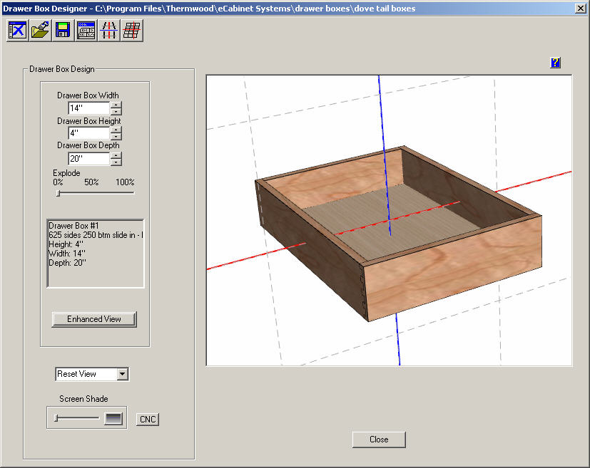

My file is attached.
625 sides 250 btm slide in - back w tails.hsf
(76.02 KiB) Downloaded 689 times
In the drawer box designer and with the drawer box opened, right-click and go into construction settings. Then just click OK to rebuild the drawer and see if that does it.
It shows just fine for me.
