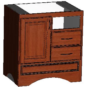

Post by Gene Davis »
We want to stick with frameless, but need a design for a little 36-wide one-sink vanity. The competition is a cheap thing from KraftMaid.
The pic, done in Sketchup because it still is faster for me to use than eCabs, shows the concept.
Can anyone suggest something simpler and better?

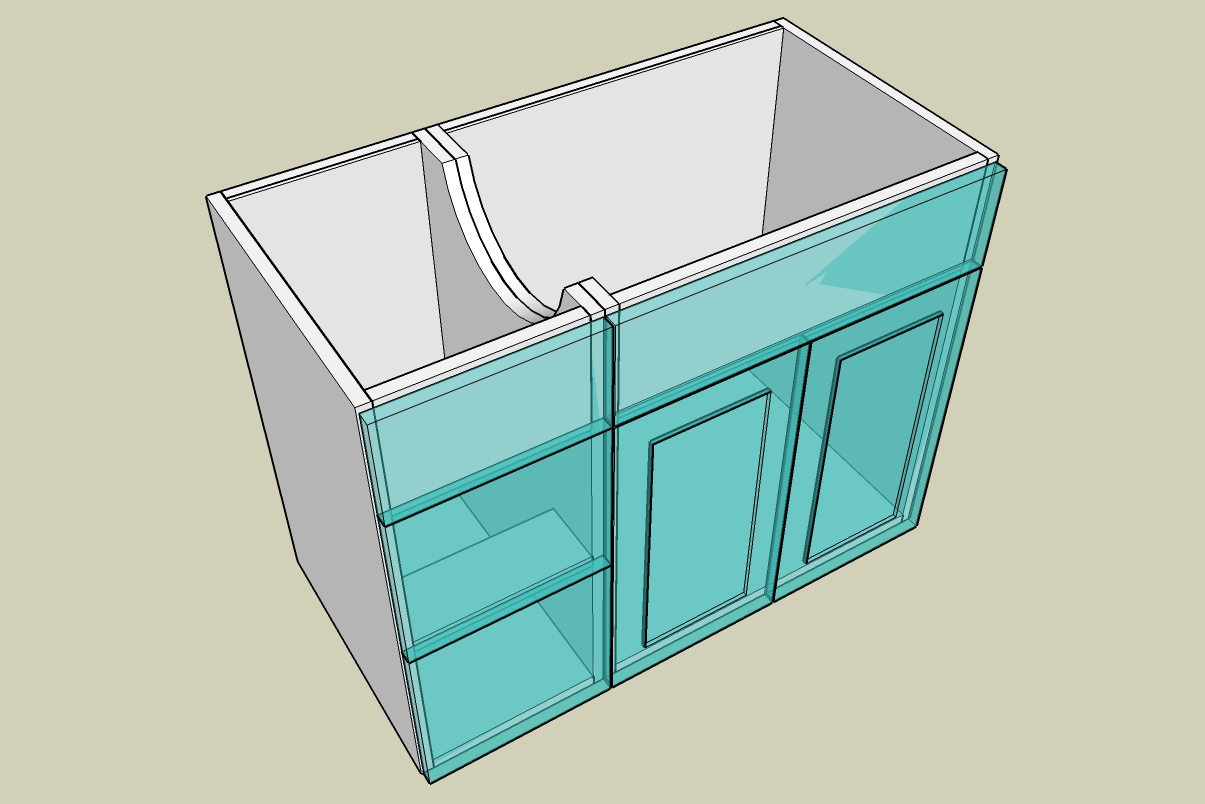

Post by Brian Shannon »
This is a faceframe cab I just finished today. It may give you ideas. The top drawer front is false or tilt-out. I built this with no bottom rail then attached a skirt to the bottom drawer front that allowed me to put a deep drawer at the bottom. The customer saw this design at H.D. but the quality sucked.

Gene Davis
Thanks, Brian, but frameless is the keyword.

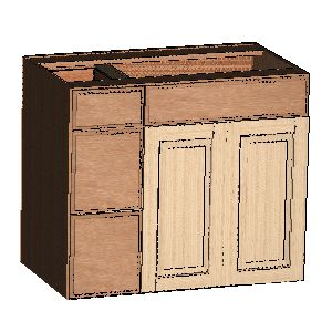

Post by Jerry McClain »
Here is one I have used. It is for an offset bowl application.
