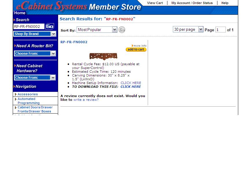

Kerry, Try searching the member store by the carving part number from the .pdf. Like RP-FR-FN0002 is the Large Front/Back Carvings.
Joe
carving page.JPG (62.07 KiB) Viewed 6386 times
Thanks Joe,
I never thought about searching using the part number. I was just hunting for the parts. That gives me exactly what I need to know.
