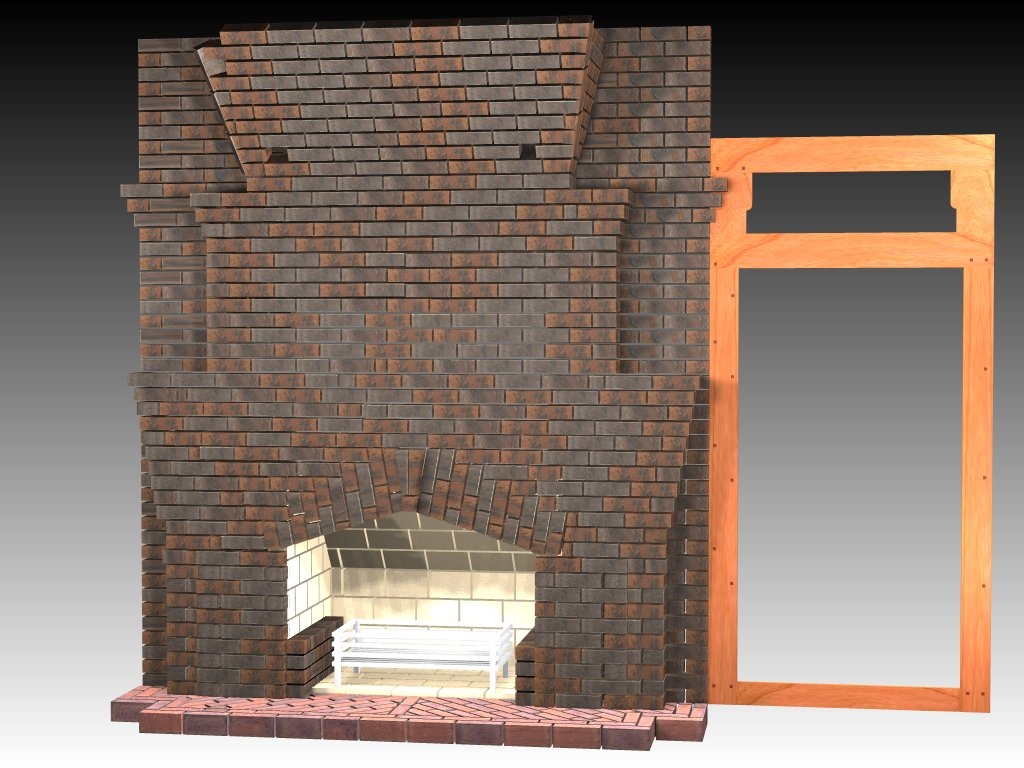

Perhaps so Dean, in the end the performance overall even in the editors is not significantly improved. As designers who spend a lot of time at the screen all we are concerned with really is how long things take and all we are measuring is user experience against cost and my conclusion is that the Quadro and similar are not worth the capital expenditure. I have test driven a clutch of graphics cards from Matrox to Ati and the improvements are negligable compared to a decent gamers card, if there is any. As an aside from this I updated the graphics driver for the Quadro to the most recent (08/07) because the installation default driver was dated 2006. I then ran the tweak utility which reported that my driver was out of date and would therefore not run. Anyone seen this problem before?
NIck,
Where the top end graphics cards help is when you have a large graphics intense job. With the lesser cards it becomes almost impossible to move objects around or rotate the job, movements have time delays and jerky motions. The top end card makes movement of objects much faster and smoother.
The graphics card won't help for things like adding drawers and the time it takes to re-generate cabinets and other annoying things like this in the editors that take so long. (part of this problem is just us though. It is like going from dial up to DSL, at first the DSL seems lightening fast and as time goes on it seems to get slower and slower trying our patience. The better we get at navigating the editors, the slower they seem.)
One last thing the high end graphics cards do make for a much better image in Presentation View. The definition and colors are much better.
Here is a test
I would like to see how long it takes other people to down load
and then take the main bricks to the edit assembly room.
It took me a min.1 1/2 to open it
It took me 19 1/2 min's to take just the main bricks to the edit assembly room.
DeskTop (3 years old)
I have a memory 1-MB
Video memory-32 MB
Graphics card-NVDIA Ge Force 2 MX200
I was going to upgrad before but I think it is time now to :?:
