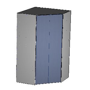

We do ours slightly different to how the catalogue sounds.
We use a 20mm set back on our cabinet end for the hinge mounting plate and drill the cup hole in the door exactly the same as any other door...
We use a 5mm mounting plate and usually minus 2mm off the cabinet opening and it works perfectly.
This all depends on how you actually set the cabinet up however.
When we set the cabinet up we sit the top of the cabinet out 6mm past the front edge of the ends.
I have attached one of our 45 degree pantry's for you to take a look at, you will notice there are no hinge mount holes in the ends, thats just because I haven't had time to do it :)
Hope this helps.
