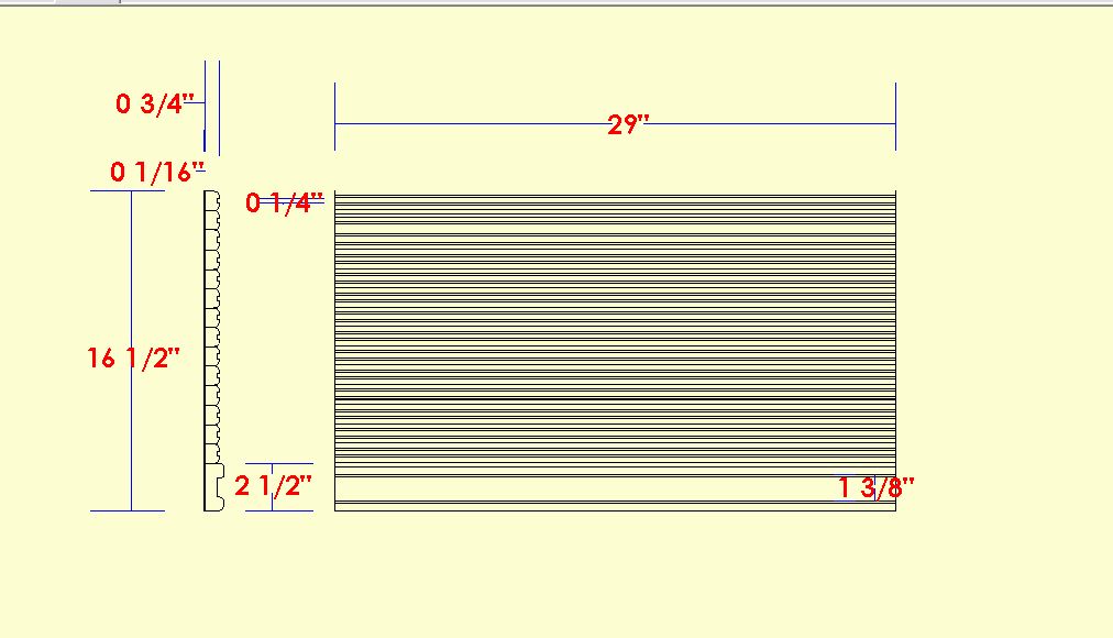

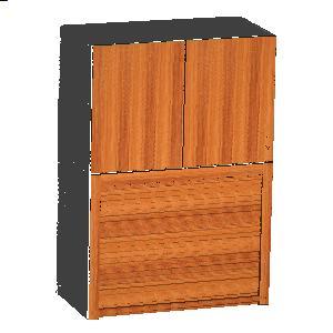

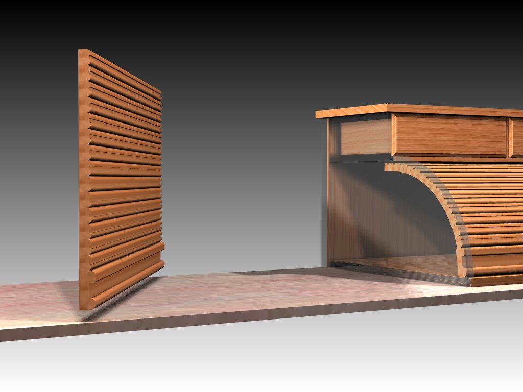

Hi Bryan
You can do something like this is this what you are looking for :?:
Roll Door.jpg (76.24 KiB) Viewed 12993 times
