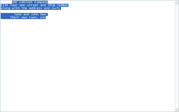

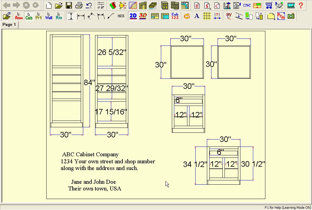

Here's an idea to help you understand a little about the software.

Michael Yeargain
Location: South East
Post by Michael Yeargain »
Here you can see I copied and pasted from a text document the information of our imaginary friends...

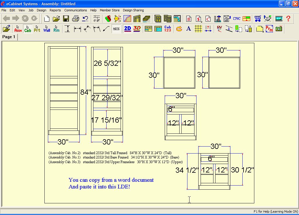

Dennis Englert
Post by Dennis Englert »
Great tip on pasting the info in.
You can also copy and paste the info from the Cut List. One small piece of info is that you must be in the NOTE mode prior to pasting the info. The text from the document file or spreadsheet file will take on the properties that are set for the text, i.e., color, size, font, etc.
Another concept that I think is worth considering. Since most cabinet's are generally alike, I would create a line drawing for a cabinet. Then save the line drawing as a job, so that the drawings for that particular cabinet type can be accessed again w/o having to do all the LDE work again.
