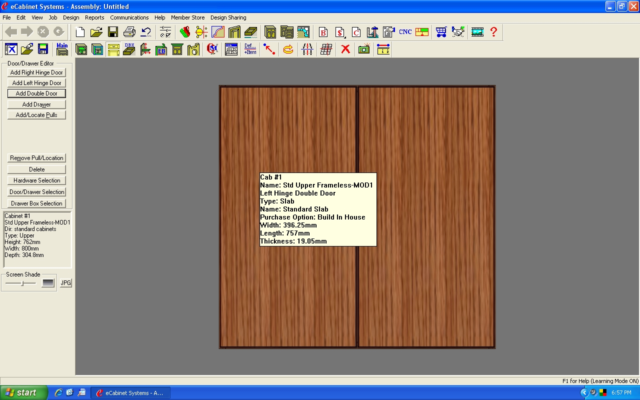

I have a cabinet 800mm wide with two doors and my clearances are set to 2.5 mm on the sides and between the doors for a total deduction of 7.5, which should make two doors 396.25mm wide. The doors generated are 396.88 instead, and I can't find where to adjust the minimum increment which is stated as being .79mm.
Any idea how I can fix this problem?

Bev,
Post your cabinet.
When I tried it I got two doors 396.25mm.

Here is the cabinet I was having trouble with. When I had it in the cab editor I changed my standard clearances of 1.25mm on the hinge sides (for a situation of cabinets either side) to clearances of 2.5mm for Finished Ends each side.
The solution appears to be selecting \"Build in house\" instead of \"Purchase Unfinished\" in the door creation area in the Cabinet Editor.

Bev,
You found the problem. Choosing Purchased Unfinished causes the doors to round to Conestoga Specs. Build In House uses the exact measurement.
