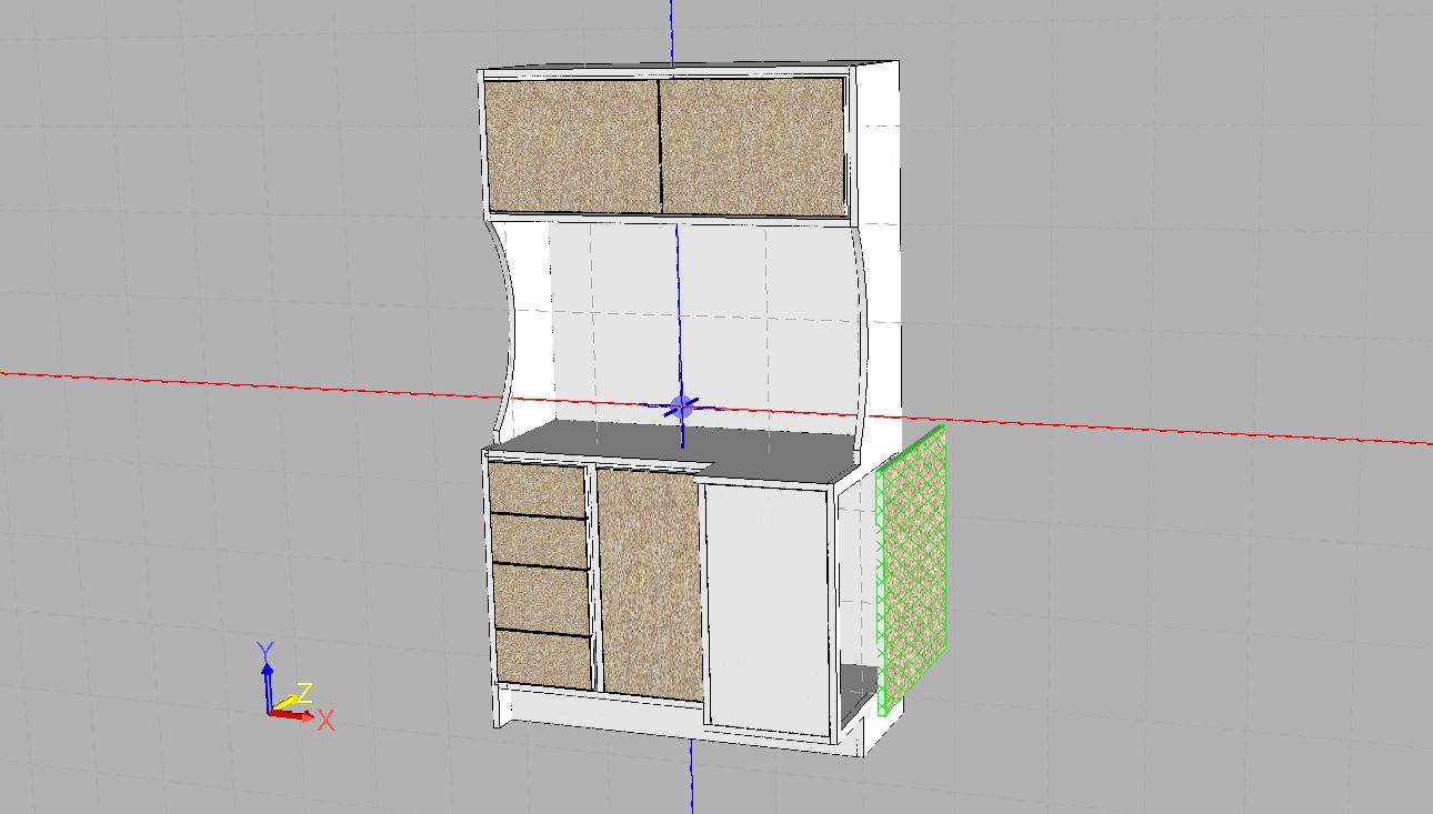

I am trying to get a door onto the side of a cabinet for side access. Attaching a JPEG of what I am attempting. I built th emain unit, then added a 2nd cabinet that had the right door size. Then I hid all the parts of the cabinet except the door after rotating and moving. But now that I want to move the door into place over the hole, I can't move the door.
So, is this the way it is and I need to make a display cube versus a door in order to get it to move? Or am I being stupid and missing something?
We really use eCabs more for generating router programs for us or our production sharing customers than for displays but this customer wants to see it and so I thought it would be a good time to finally learn how to make great displays like all you gurus out there!

Rob,
why don't you take the side of the cabinet into the parts editor and cut the hole into the side and then target just a door onto the screen and place it on the side of the cabinet like a finished end panel.
That is my suggestion provided I understand your delimma.
Damon

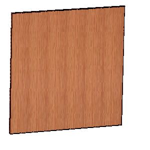

Is this What you are talking about?
Damon
Damon Nabors
Damon Nabors
Posts: 923
Location: Marion, Ar.
Post by Damon Nabors »
I am going to try this again. not sure what I down loaded the first time.
Damon
Damon Nabors
Damon Nabors
Posts: 923
This time a little larger view

Yes, that is what I am trying to do. I can accomplish this with either a display cube or an importred door. But becasue we use these to actually cut them on a router, I wanted to get a door that would nest and I could cut witht he rest of the job. I am not just going for looks here. I accomplished the \"look\" with a display cube and so on.
I admit to being a novice on doing the \"odd\" things here, even though we've been using this for a couple years. My point was to do this only once spo that when I go to machine it, I won't have parts I need to program separately, etc.

Rob,
Get your door with 'Load Item'. Position it where you want it AND THEN...
Very important:
Select the door, double click the cabinet so that the outline of it turns green. Right click with your mouse pointer over the door and select 'Associations > Associate to cabinet'
You may now save the cabinet and the door will nest like any other part. (provided you chose 'Built in-house' when selecting the door)

Just thinking out loud here, but couldn't you make a faceframed cabinet of the appropriate size, . . .
delete everything but the faceframe and a \"build in house\" door, . . .
specify the frame as made from boardstock described as \"DO NOT CUT,\" . . .
then bring that cab into your model with the one in which you have made the hole in the side, and bury it,
Then save it as an assembly?

If you place the cabinets in the room (not as an assembly) you can select the cabinet and add a door using right click>adjust cabinet features>cabinet end. Or \"S,J,C\" from the key board short cut.
As an alternative, while in cabinet editor, you can add a door the size you want or as Gene mentioned as well,
Gene, there is another method to this, using a frameless cabinet, delete everything except the back, do not cut.
This just goes to show you that there are several ways to accomplish what you want. No matter what you do in the editor, make sure you associate the door/part to the cabinet before you save it.

To All,
The best way I have found to place just a door (in batch or in a room) is by using the following steps from Scott Vaal to create a cabinet with nothing but a door that will re-size correctly. There are no \"do not cut\" parts with this method.
From Scott: \"I don't know if you batch doors like this a lot, but here is a fast way to do it by creating one (as a cabinet without other parts) and then changing it to any size in the batch.
Follow these to the \"T\"
1.) Load the std base frame less.
2.) Delete all cabinet parts except the toe kick.
3.) Go to door/drawer editor: set the door you want default and then add it to the cabinet (do not change any door con-settings).
4.) Return to main.
5.) Go to con-settings -> toe kick tab: set the Height and Inset to zero, and uncheck \"Has Toe\", select OK.
6.) Save this cabinet and then batch any size/Qty door of this style that you want.
_________________
eCabinet Systems\"
Just select this door saved as a cabinet, re-size the height and width as you select it and place it in a room or batch. You can save different doors as different cabinets or just change the door for this cabinet each time in the cabinet editor.
