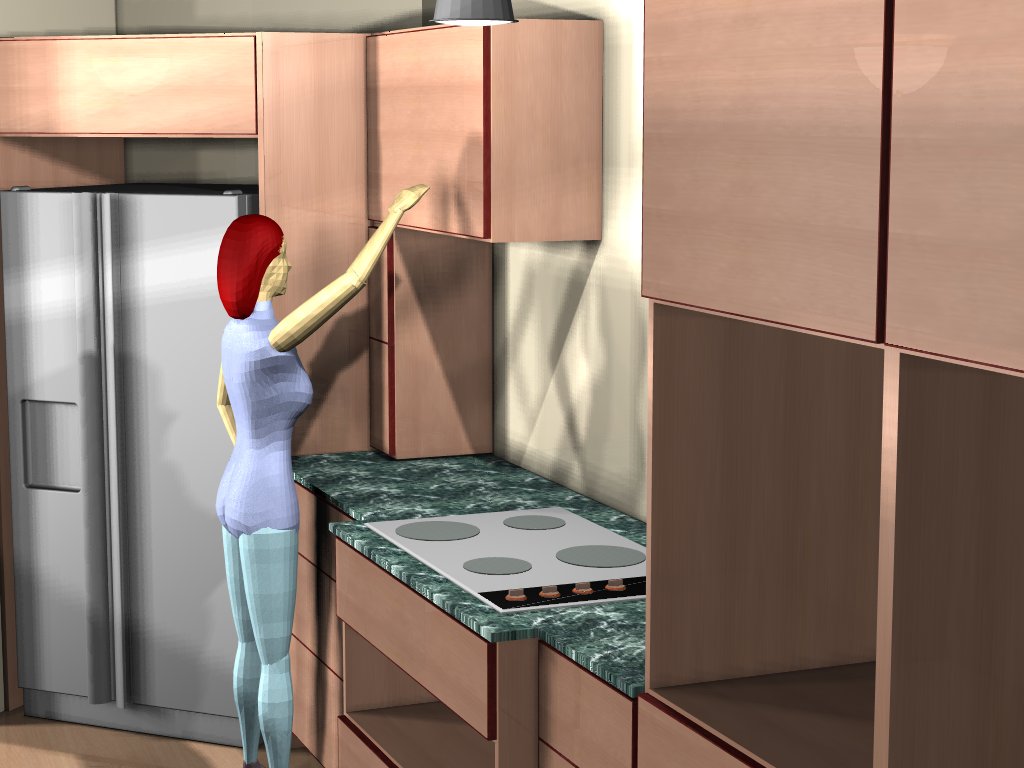

Did it in display. Not the best, but at least I can show client that lift up doors on uppers probably won't work if you are short.
Thanks for all the help
Jon
raised sample.jpg (95.7 KiB) Viewed 20317 times

This is the reason I have been working with 3ds Max & Poser for the last 18
months. Problem is I can't import to e-cabs so that the models look real, instead of a polygon sketch.
I would like to be able to import life-like human models into my presentations. So that just like Jon I can show the client any limitations.
Dave Norton
